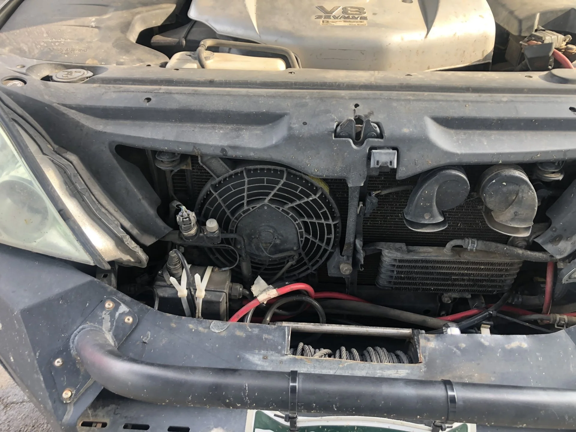

I’m on an extended work trip, so I don’t have a garage or tools. I was replacing something with my winch when I noticed that some rubberized tubes are worn and cracking. I would buy replacements, but I don’t know what they are. I would also normally pop them off and check, but they’re pretty worn out, so I don’t want them to fall apart and leave me without a vehicle. Transmission? Anybody know for sure?
**The shiny red and black lines are the power and ground to the winch. I would make an arrow to the tube, but I’m on my phone. It’s the junction of the metal tubing.

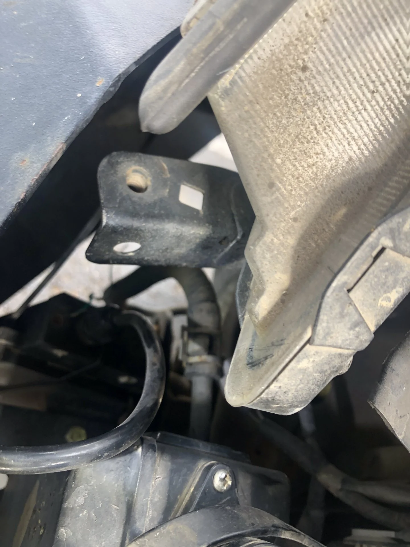

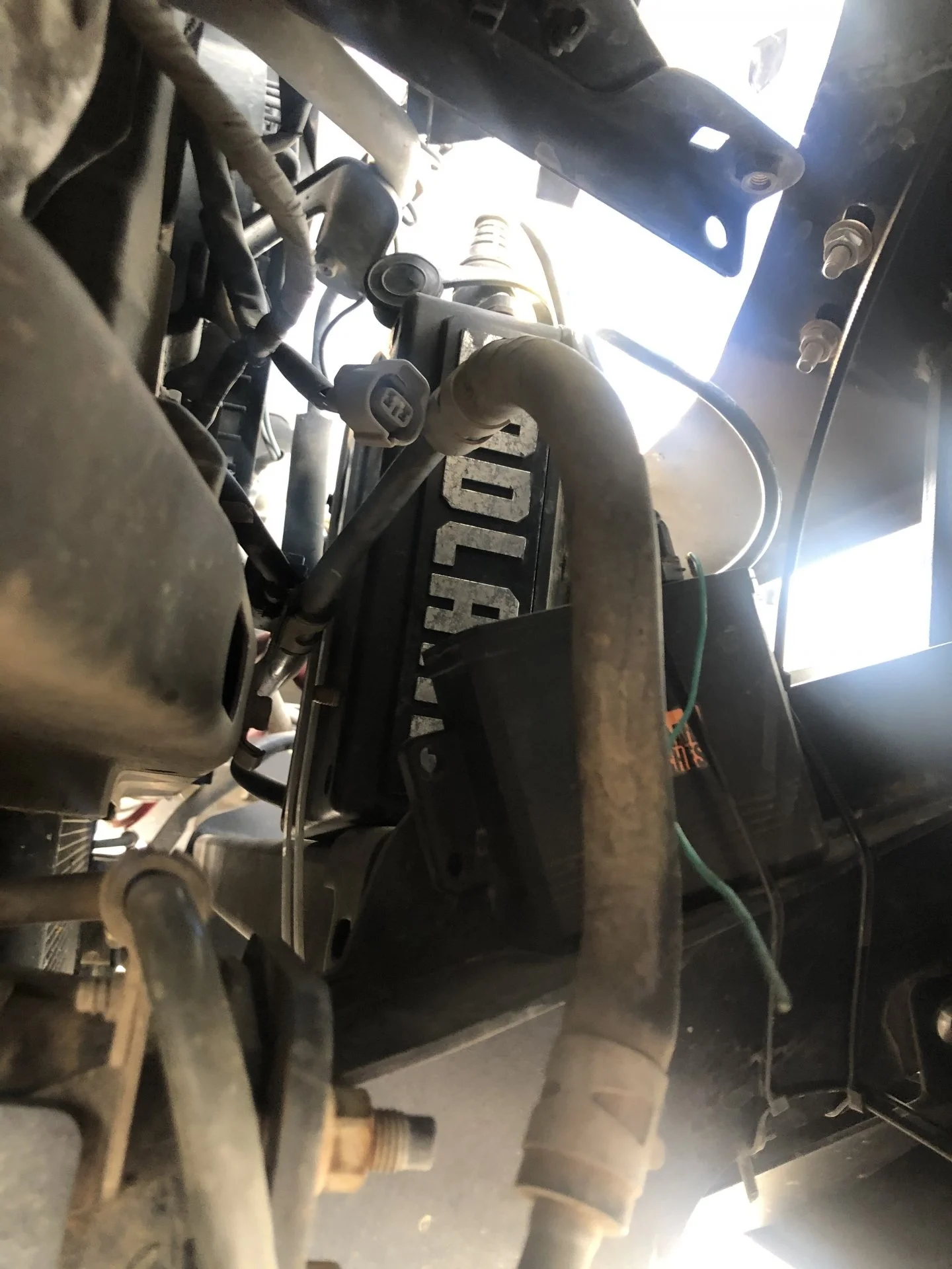

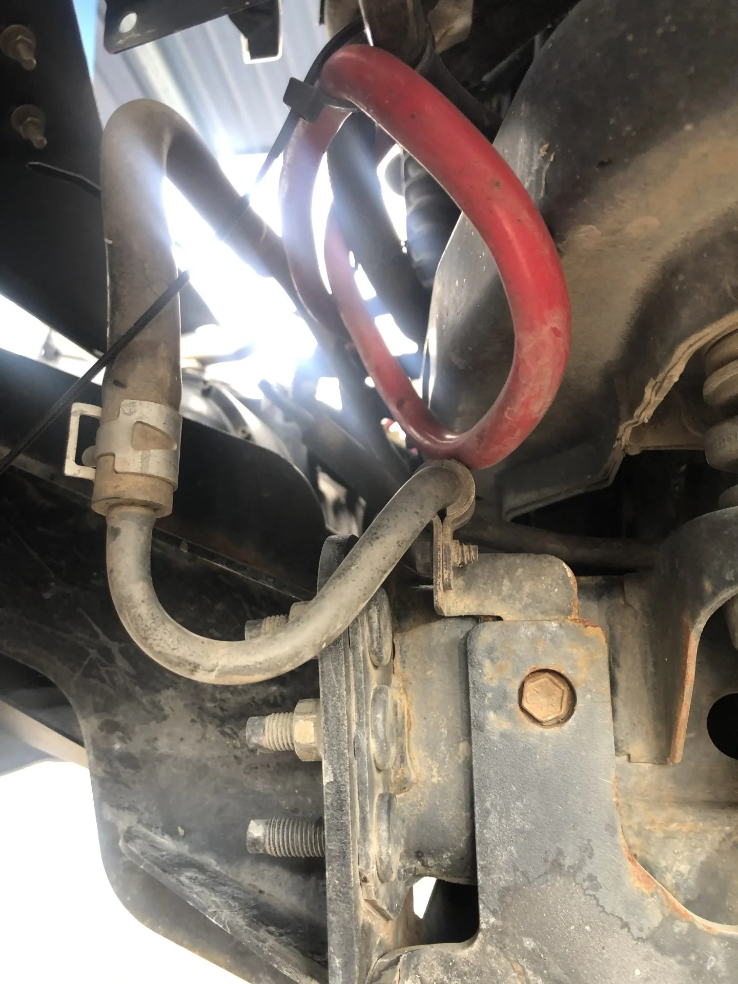

Ones going to the black cooler are transmission. The one in the second picture is power steering I believe. This one is off the top of my head though
The second, lower line that does not feed into the mini-cooler in front of the radiator is indeed a power steering hose. I would buy a few feet at a parts store and replace it; power steering systems are easy to refill and bleed.
