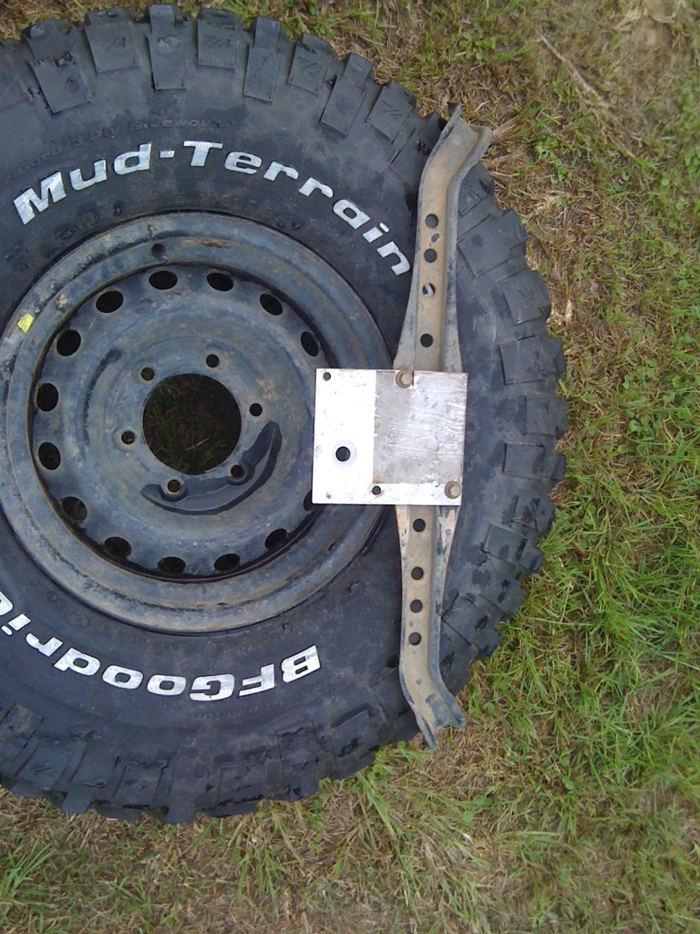

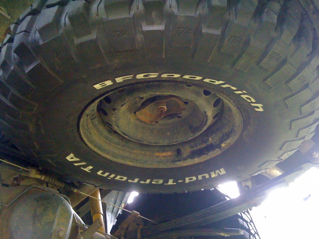

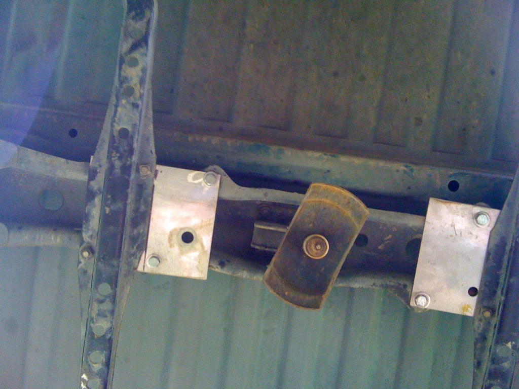

I mounted my spare 33" in the spare tire well. I pulled the brackets off, found what metal plate I had, and fabbed up some crude extensions so that the 33 would be snug underneath. Unless you just want it topside, this is way easier and cheaper.
^^X2 I just did the same thing replacing my OEM 31" POS Goodyear Wrangler with a BFG AT 33X10.5.
