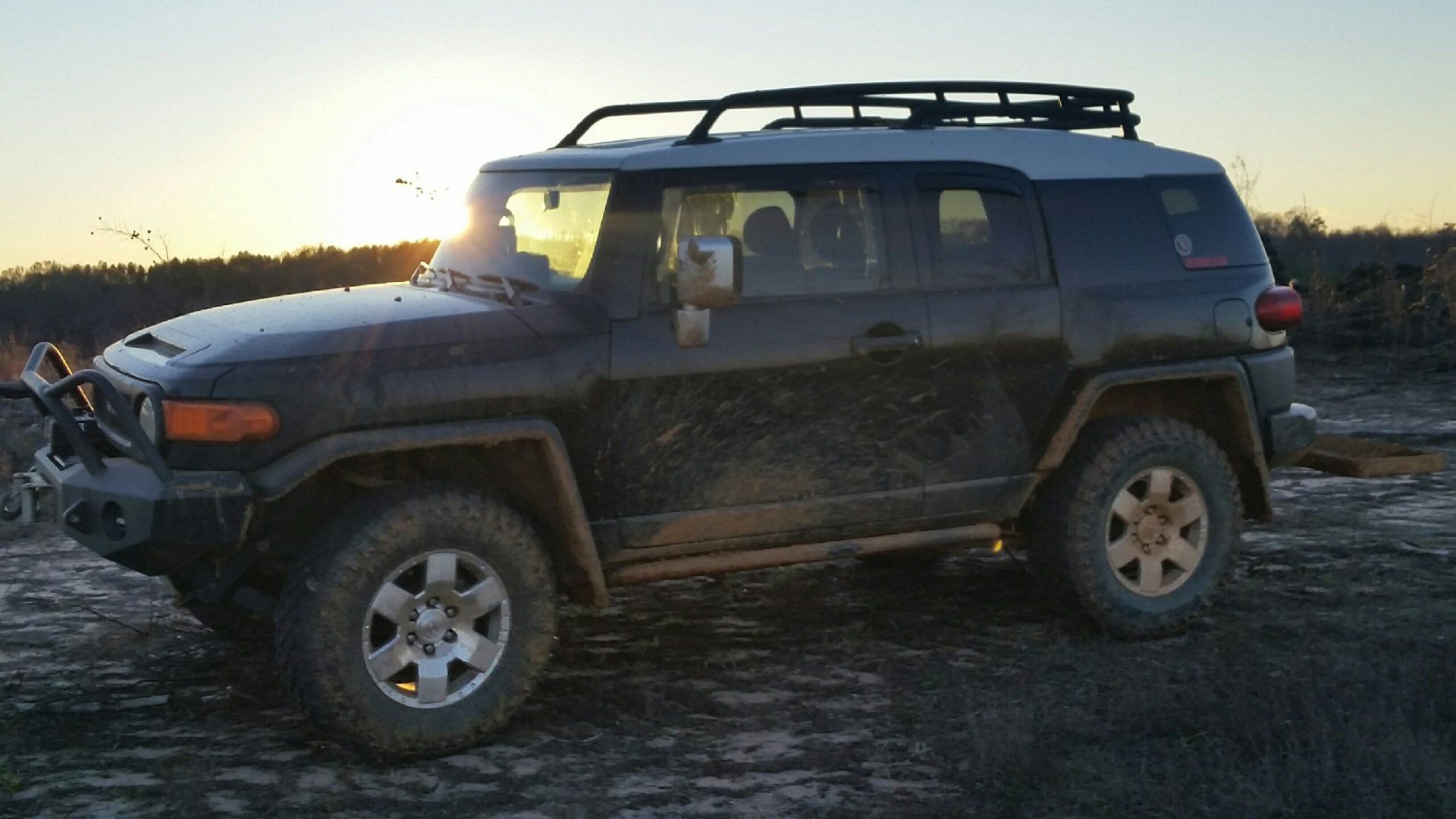

I have a new picture to grab later. We went off this past weekend with the upstate SC guys , Had a great time and no issues from the FJ.
Made a tire change this weekend to Falken M/t's. Was not my first choice but I got a screaming deal.

This is the only picture I have at work.
Dobinson's control arms are on and an oil change is done.
