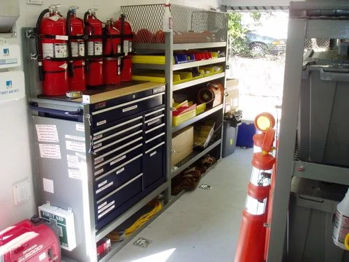

Just to follow through, I purchased 2 Wells Cargo 20x8.5 .
I loaded them up with good stuff ( to the budget 14,000 per unit)
I have started one and about half way through.
The drivers side storage/work unit is 95% complete .
The pax side is a couple hours into it.
Anyway here some pics... :cheers:

Just to finish this out:
Here are som pic's from the"completed" trailer after its first mission (kinda a mess)
There are some small things that need to be done to make me happy, but the crew and the boss had no complaints:)
