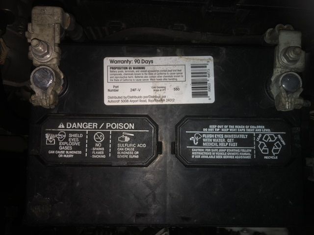

Doing a search. I'm seeing 27f fits a standard tray. Is that the largest size I can fit using the same cables? Here's a pic of the battery I have now. There is a ton of room left with this 24f. I can get an Interstate 27f that is in stock now or my auto parts store has a Diehard 27f in stock.

I am replaced my OEM with the interstate 27f . No issues to report. Had to reset the window switches after the battery swap. If I remember correctly you Hold down each window switch to open and then close, otherwise the driver switches to control each window may not work.

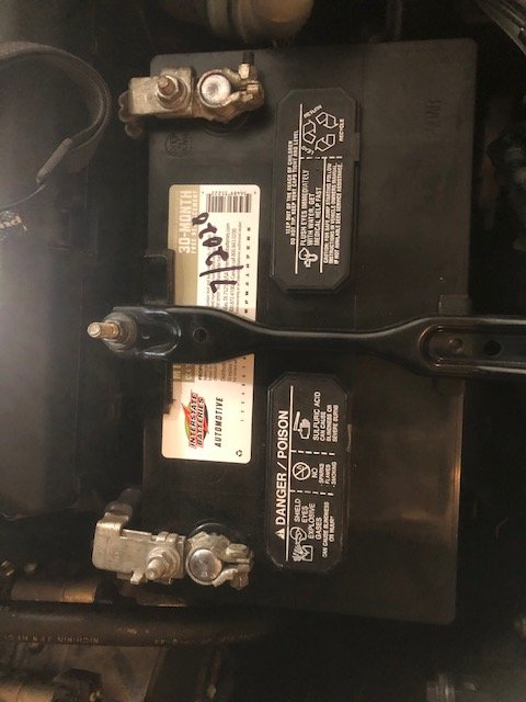

Another (small) project complete. $112.00 with core but the auto parts store didn't have a pos. rubber cap. I cleaned up the cables and ground wire real quick before installing. This battery fits real nice BTW.
