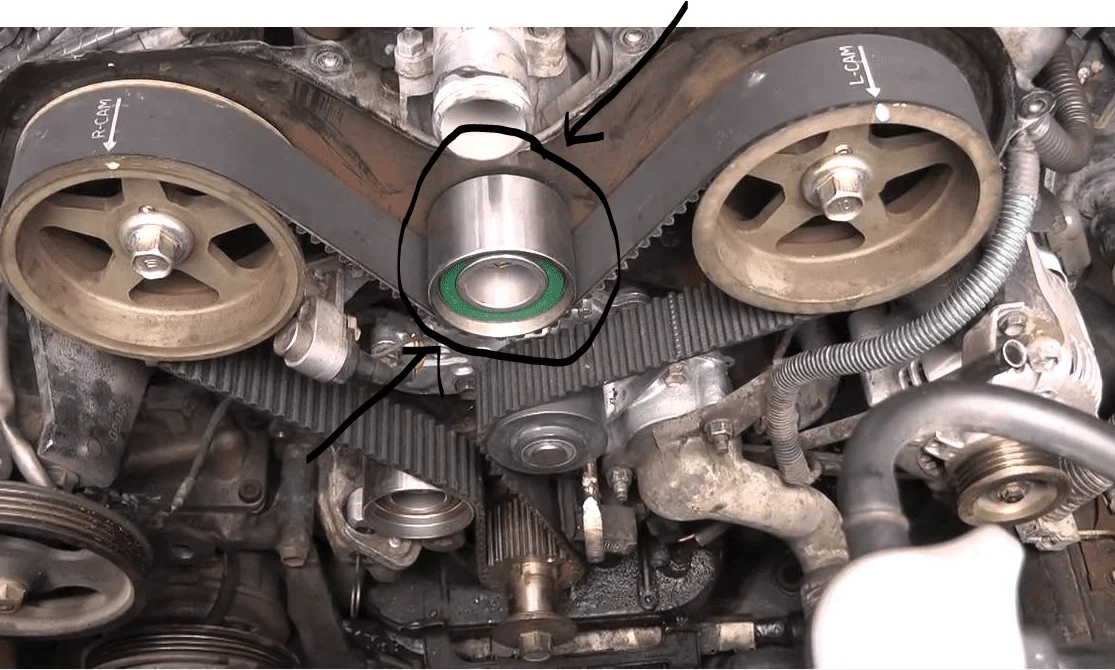

The cam belt continues to not want to go on. New belts seem to be 1/2" too short. Always it seems that I have a tool I need, but it is in the other garage at the other location. Always. But I came to town last night for a dinner with friends, and now have a couple tools that I believe will help the situation. Looks like it will be nice and warm Saturday so may get it on then.
It took a lot of head scratching for me too with the Timing belt. I think I had to re-do it like a half dozen times. Oh, if I could only get that time back...
With the 5VZ-FE, there is an upper idler pulley which is between and below the cam pulley's. You actually have to have this idler pulley removed, then you line up and install the belt, then install the idler pulley. Once I figured that out it was pretty easy.
It's a pain to get those timing belts on. I've done a bunch of them. Best thing I learned about toyota timing belts is to line up the marks on the cam wheels to the marks on the engine- and to hell with the marks on the belt. They don't ever seen to line up correctly. The two cams and crank marks being in place are all that matters. You can work those belts on with the idler in place, just takes patience.
