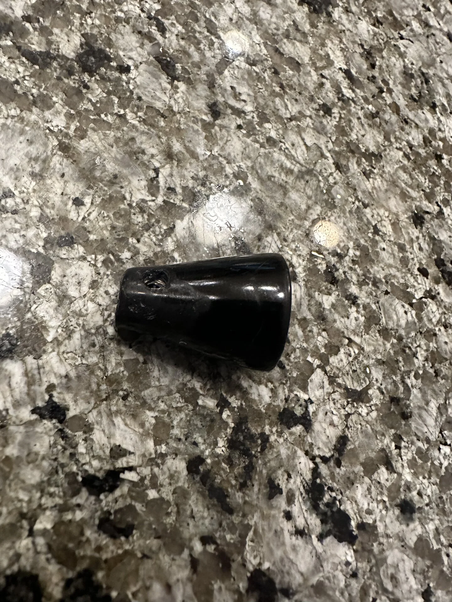

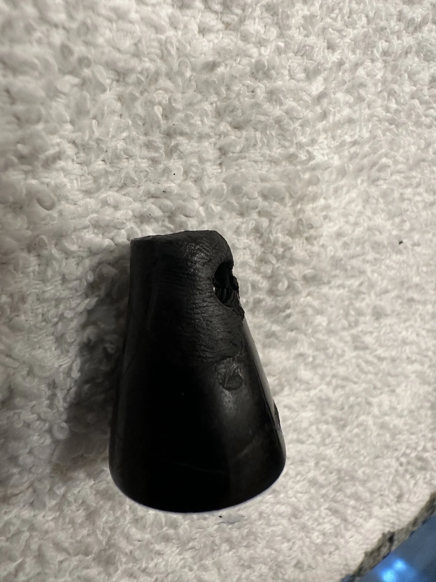

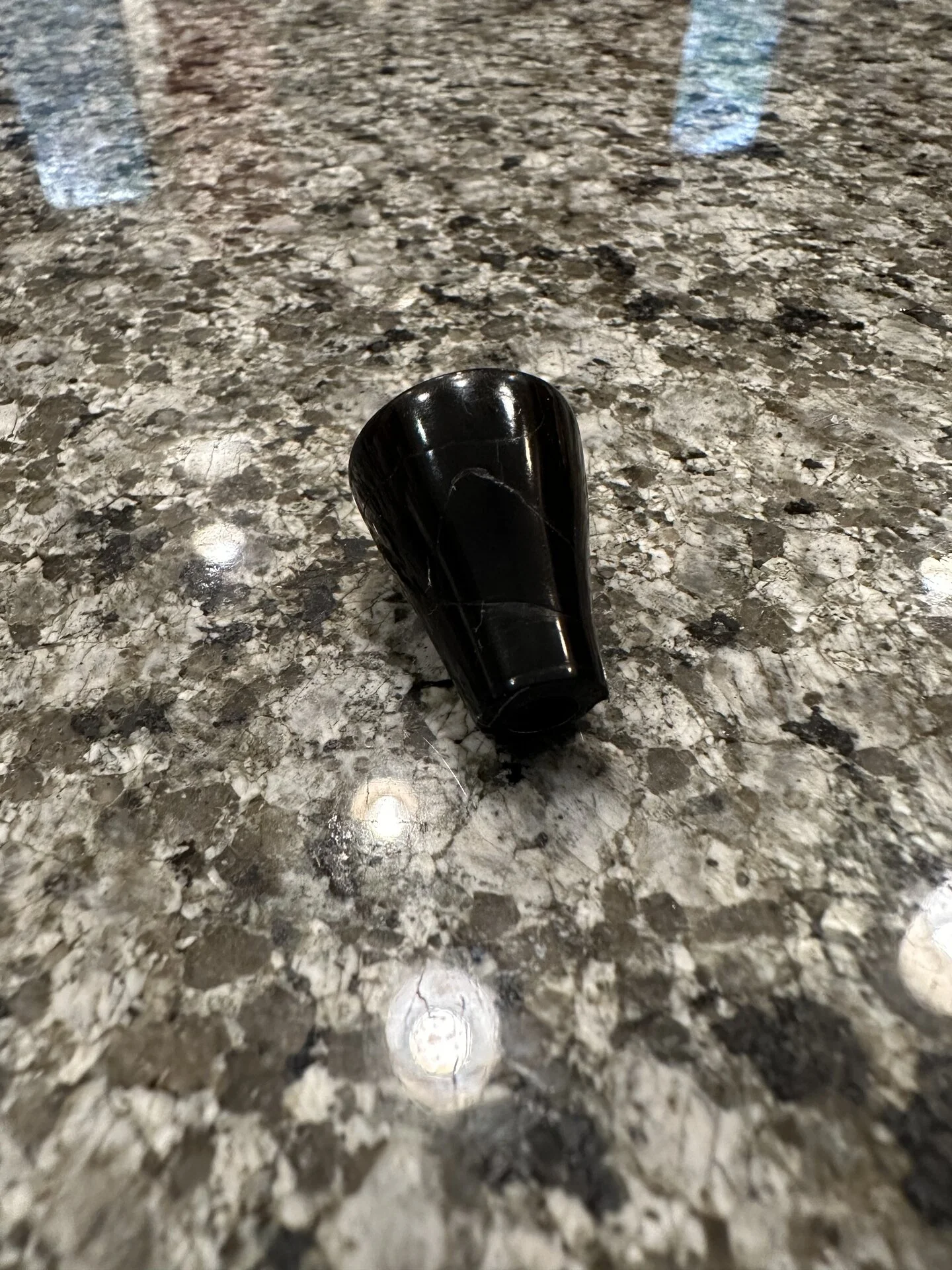

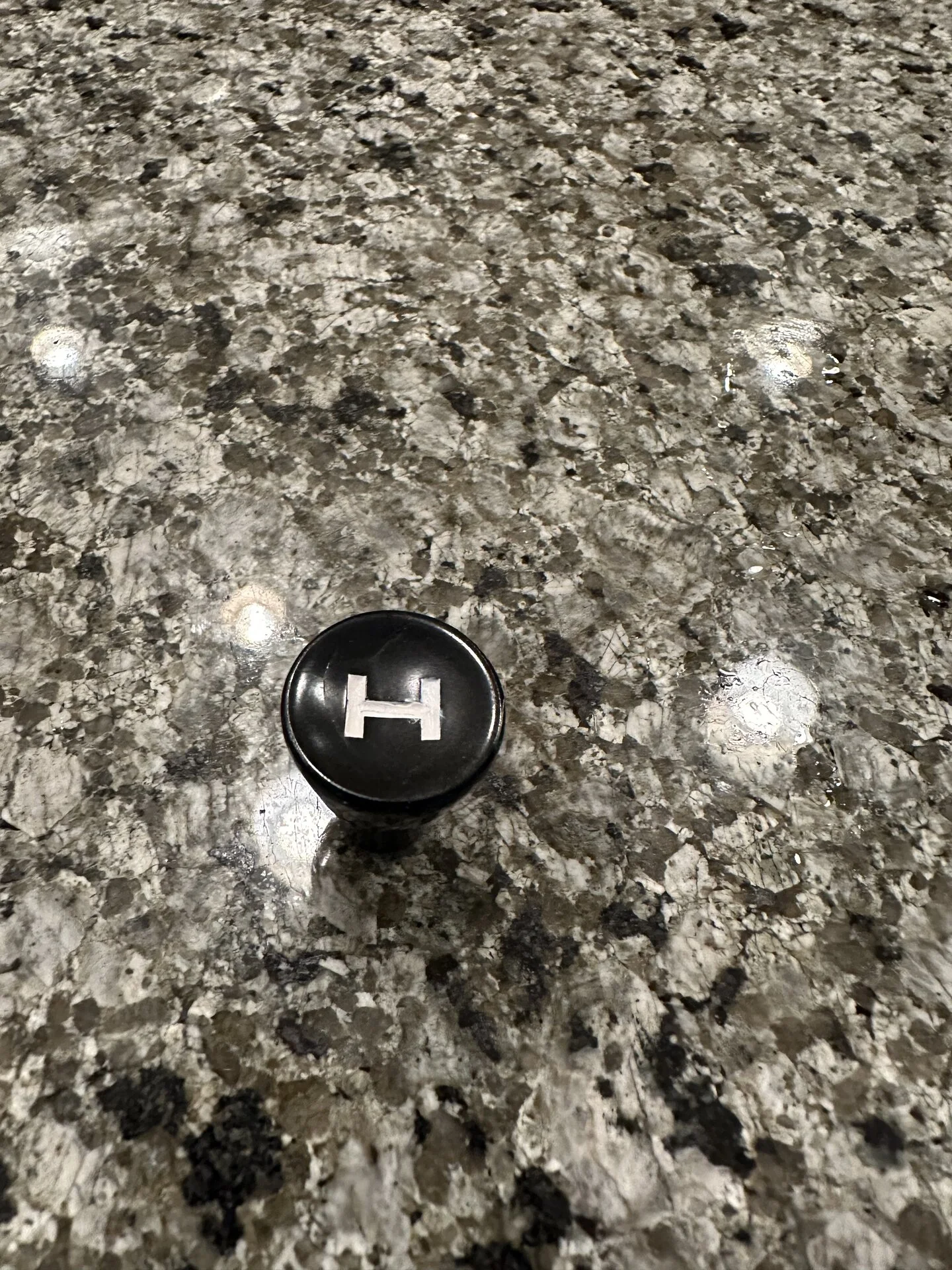

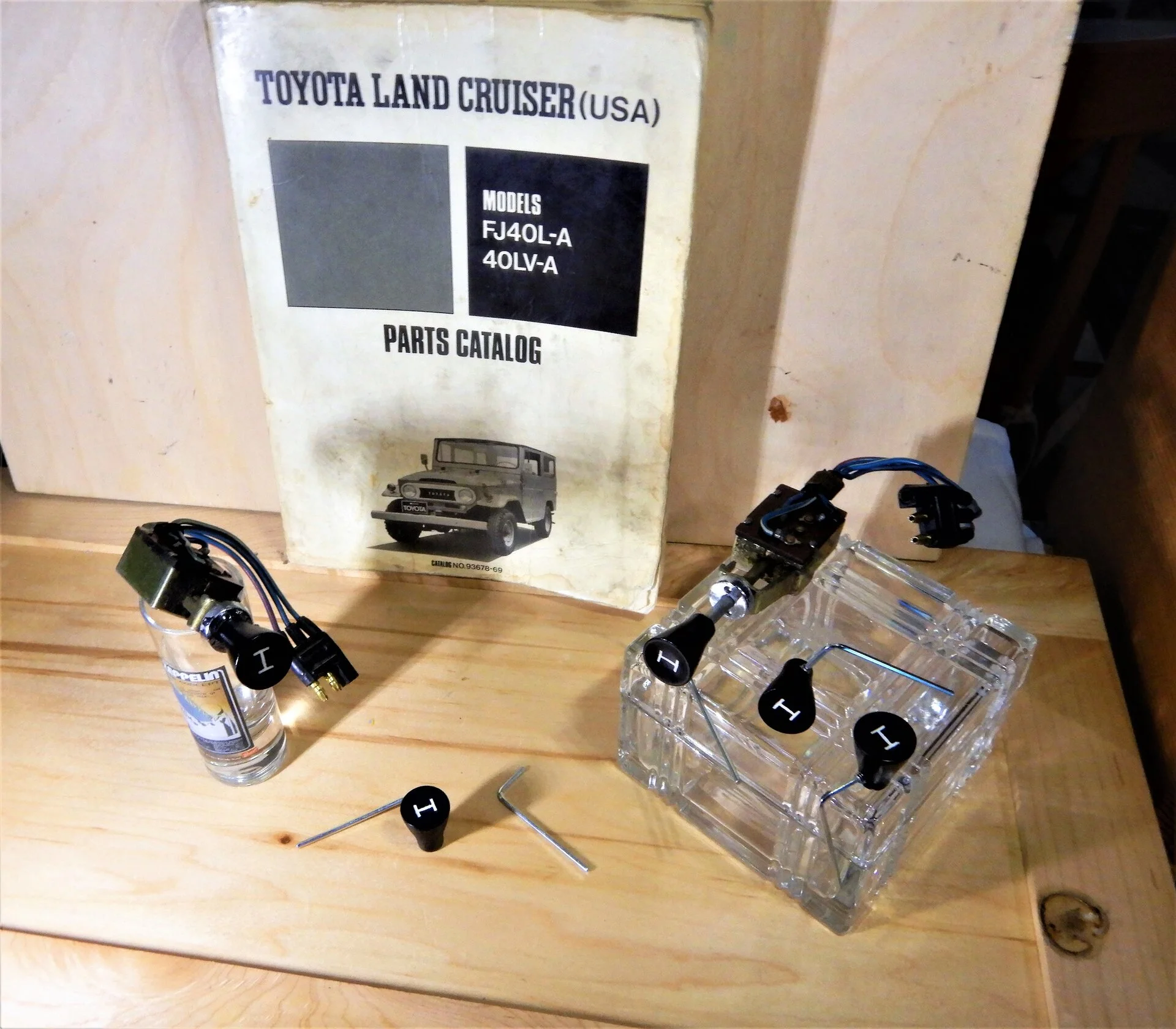

My H knob was cracked and missing about 1/3 of its plastic. Filled it will black Milliput putty. Wet sanded with 220, 1000, then 3000 grit wet or dry. Then polished with glazing compound. Snagged some white acrylic paint from the Wife's painting supplies to refill the H. It turned out ok.
