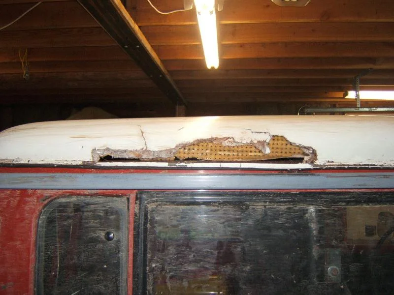

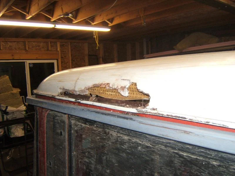

I f'n H8 trees! Well I was out on a trail called Fungi and shouldn't have had my roof on... I was on a bypass and got slammed against a tree... Well my roof sliders on the side of the hard top saved the glass but a stub of a branch poked throught the fiberglass right above the gutter and I couldn't drive out of it (unfortuntatly I tried), I now have about a 16" gash.
I want to do a quick and dirty hack job repair of the top to keep the rain out, a few steps up from duct tap. The top is pretty trashed already and its not worth finding another one to trash too.
I searched 40 tech section but could only find restoration and gel coat info. Does somebody know what kind of resin to use for the repair? I was gonna use some fiberglass mat. Seapotato do you have any experience with fiberglassing these tops?
I'll get post some pics later...

Heres the pics...
holy speed hole batman
Nice work.
You could cut it to a decent shape and bolt on a piece of plexi...then maybe you'd SEE the fawking tree next time and not run into it...:flipoff2:
I should get a window like the rovers have!
I could handle the tree, just not the stub of a branch that made the whole.:rolleyes:
