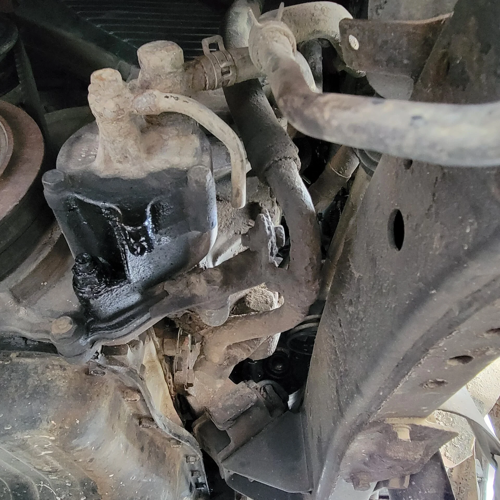

As it reads boys , I got the drip ...lol... not sure what it's coming from tho . Hoping somebody knows and let me know if it's a easy fix , this is pretty much the only leak I have on my old pzj 75 . Thanx fellas
Coming from the vacuum pump housing.

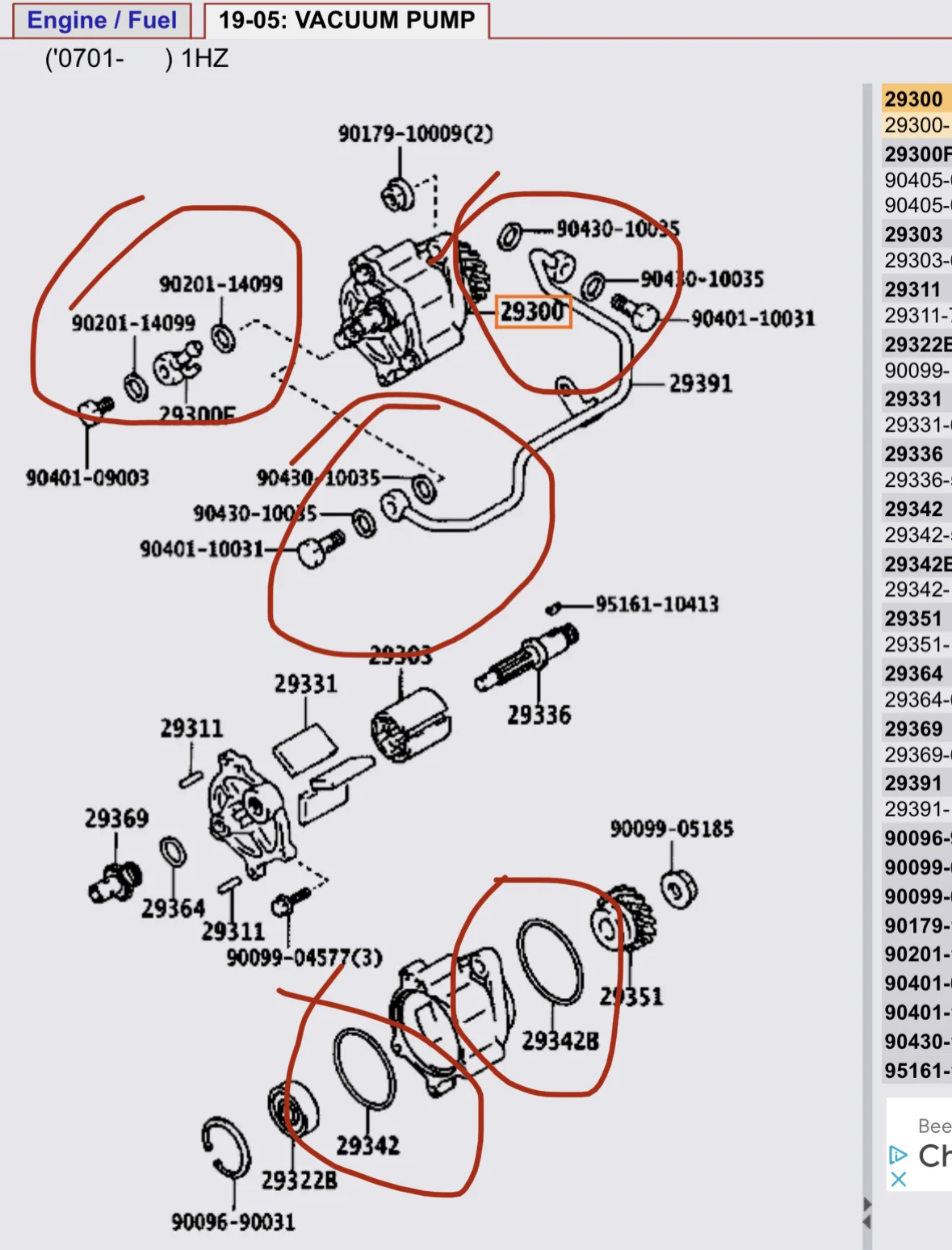

The circled areas are your gaskets and o-ring seals.
One of those is leaking. Rebuild or buy new, friendo.
Thank you for the diagram , I wonder if the seals and o rings may be available in a complete rebuild kit .
Actually now I look at the diagram a bit more it looks as tho it's all o rings , might not be that bad of a fix .
