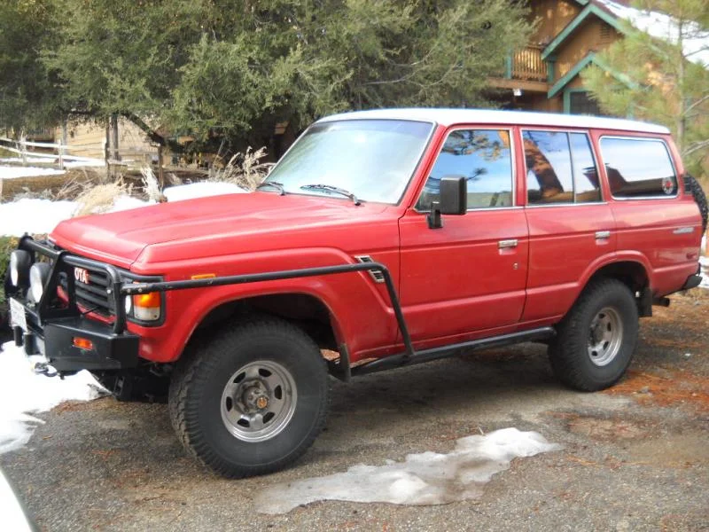

I finally got around to putting some BFG MT's that I got from Craigs List a while back. I found a set of five and one was brand new while the four were slightly used. Then I scored another new one. I put the new ones up front and the the used ones in the rear.
Love how they look compared to the 32x11.5's I was running. They seem to handle the same if not even better than the AT's that are still on my other rims. Because they are skinnier I think they are a little bit more responsive.
They do seem a little slower from the line but they also seem to have a little better gearing for the highway speeds.
The fit the wheel wells better than the smaller 32's I was running that's for sure.

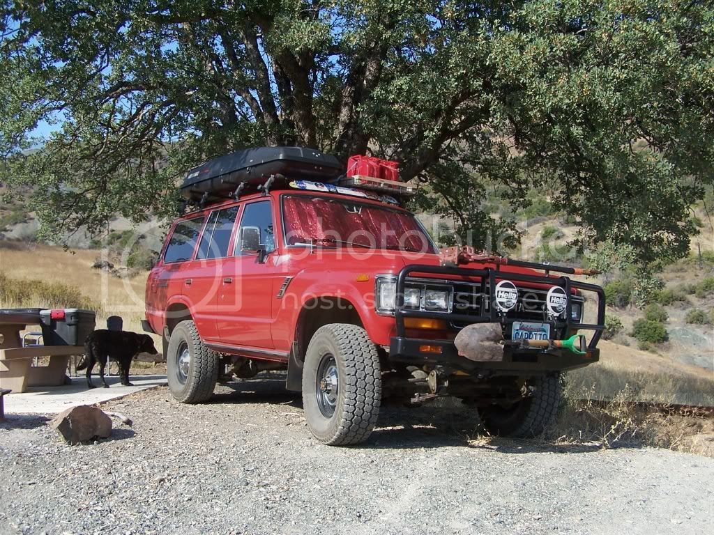

The truck looks great with those tires!

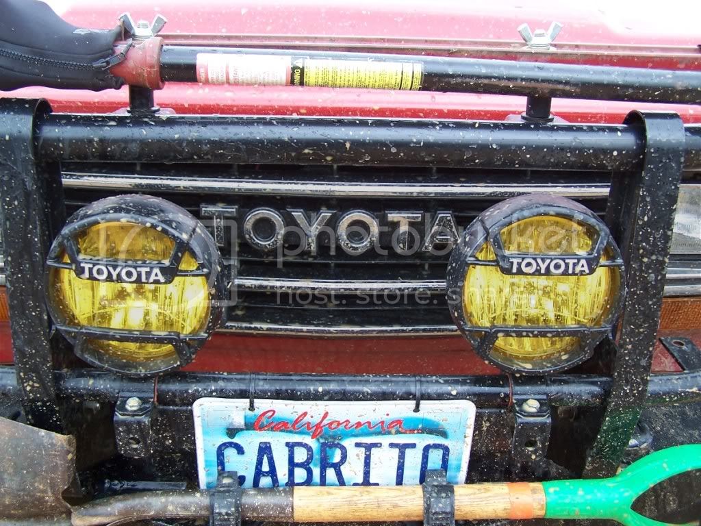

The fog lights look good, too! :hillbilly: :cheers:
Thanks Mot, some people think I'm some sort of official when I'm behind them. :cool:
