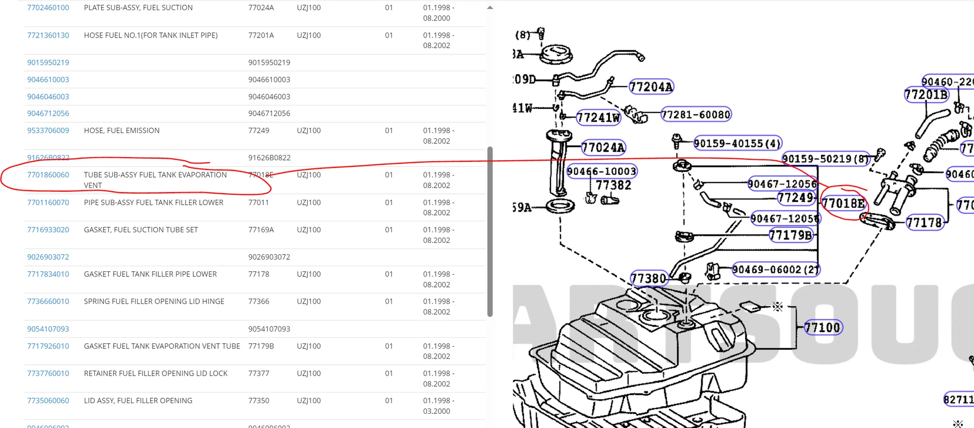

No real idea, but was interested enough to check partsouq for a diagram... Is it perhaps this one?!?
