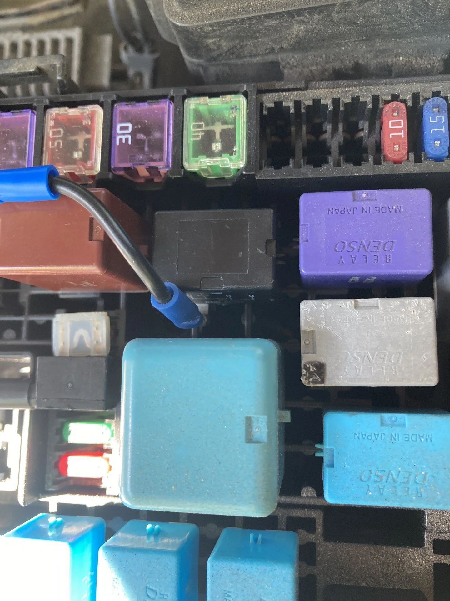

So I performed the first part of this mod:
Toyota 4Runner Independent use of Fog Light Mod

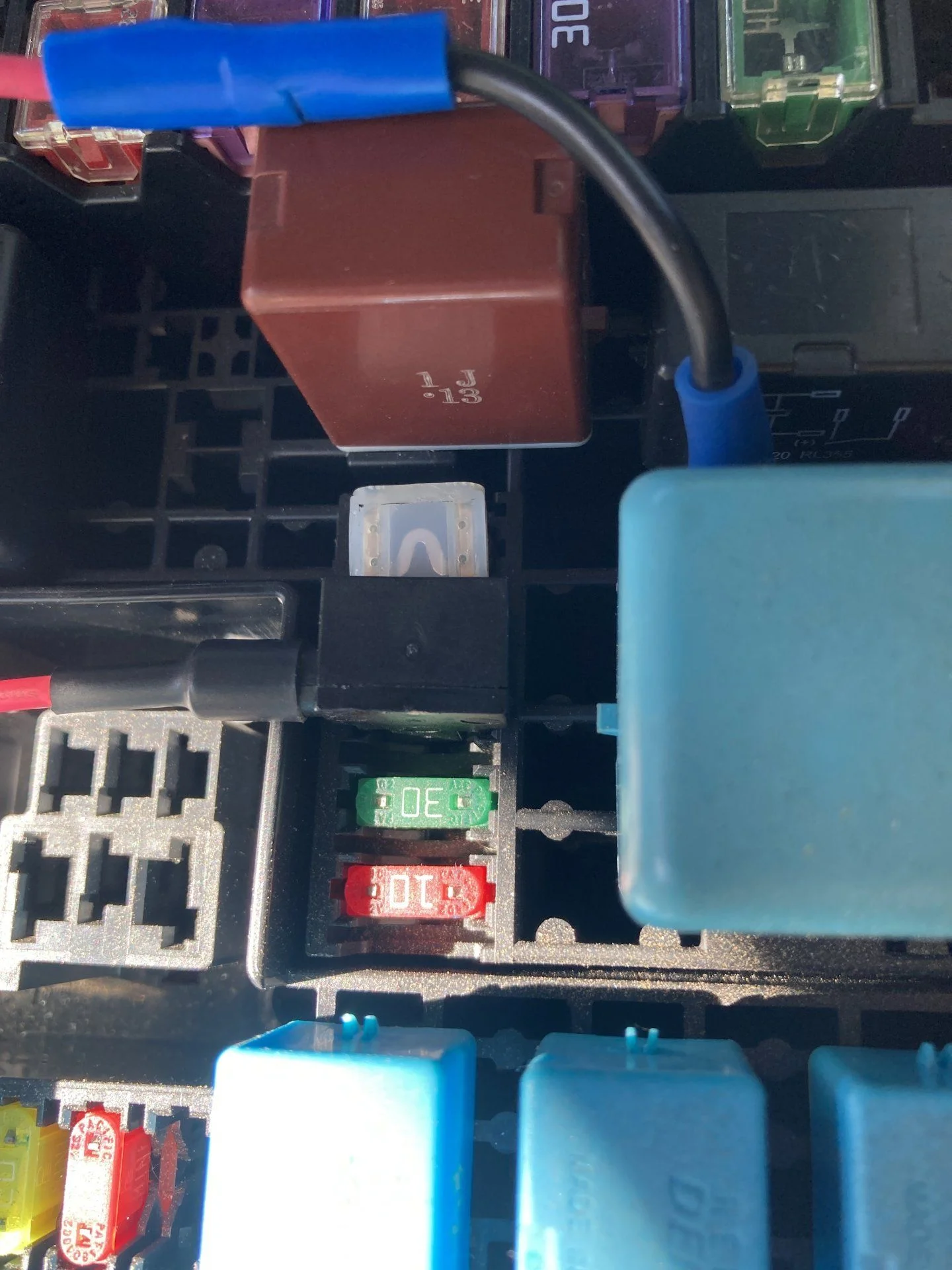

Like it says, I bent prong #2 of the relay and attached the adapter and ran it to the 25A seat heater fuse. The mod works great, I can use the fog lights whenever I want. But seat heaters are shot. The switch still lights up and acts like it's getting power, but no heat. And if I remove the adapter and put the fuse back to factory condition, seat heaters work fine.
So what is happening here? There are 2 slots in the fuse adapter. Are there suppose to be fuses in both slots? Why is power not returning to the other side of the fuse slots on the car side?
Yes...the top fuse slot is for your new circuit. If you didn't put the seat fuse in the bottom slot you've done the same thing as totally removing your seat heater fuse

captainva was correct! You need to have two fuses inserted to complete both circuits. If I have the single fuse in and swap it to the other slot, then my seat heaters work and fog lights don't. Swap it back, fog lights work and seat heaters don't. Just have to add another fuse.
