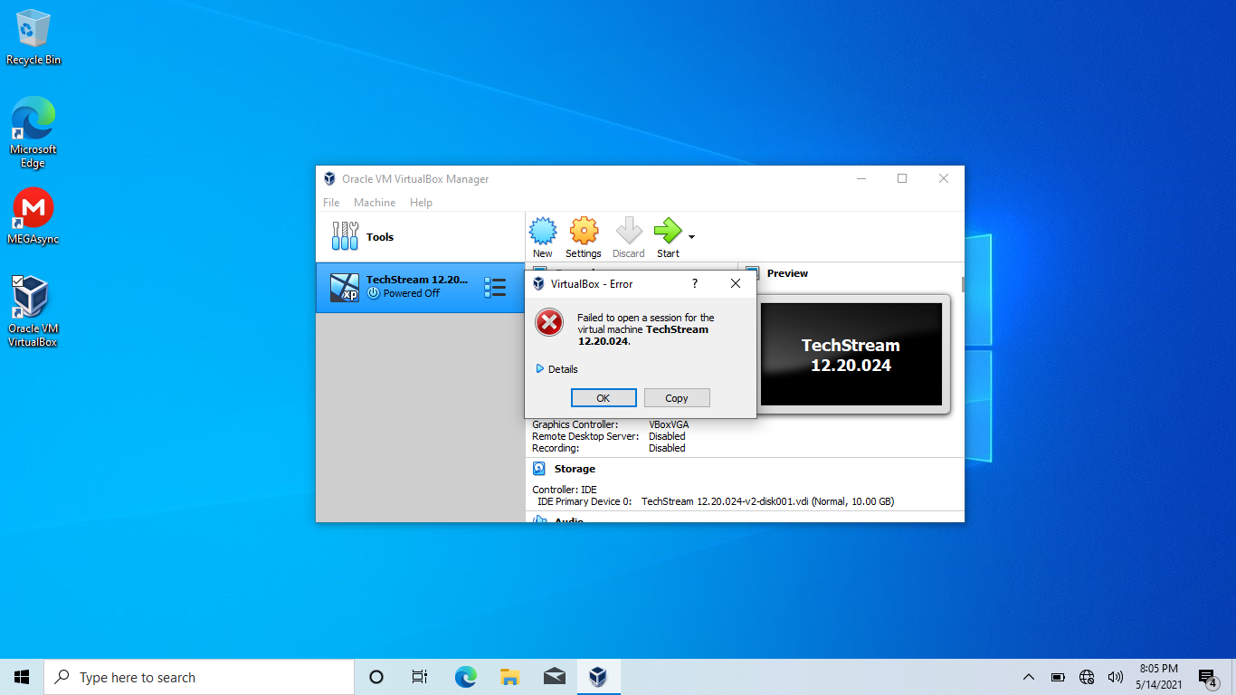

Have you found/reviewed this?
I went all of that, step by step: here's what I got:
