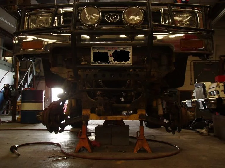

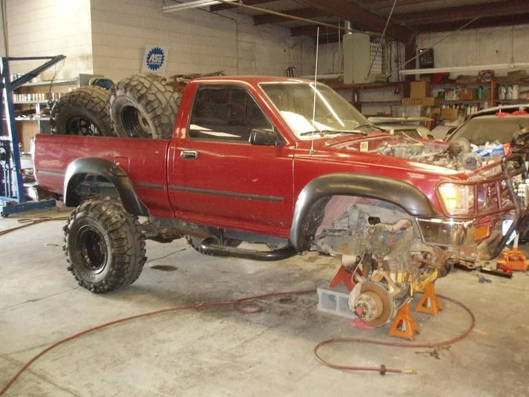

Well thanks to all the oppinions I recieved on wether or not to get the 93 pickup. I got him to take 1200. The bad news is I pulled the motor last night and there is rust on the crank and the bearing surfaces:doh:. SOOOO I am looking for some options from you guys? rebuild? what would I all need? someone said something about metal chain guides?
Engine swap? I was thinking 3.4 but I kinda want to say arround 1000-1500
Junk yard motor? get an old 22re? I need some opinions on this and maybe some links from stuff you guys have done. Kits and such. please get back to me. Thanks I'll post some pics.
