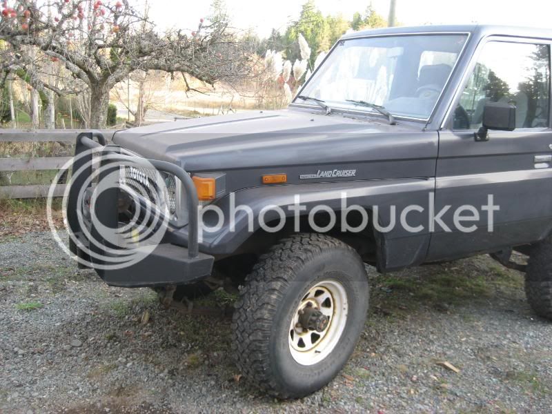

Basically every day at work, I can see the truck through the window, and the front bumper has been annoying me for months, so I finally got around to making a new one and getting the winch back on the truck.
Was going for the ARB sorta look , after seeing the thread on blackflag where a guy built cool bumpers for his unimog, I wanted to have a go at it.
it's not quite done, have to take it off, cap the bottom and gusset a few spots, and I need to get a bit of tube bent for the bullbar but I'll get to that one of these days.
Anyways couple pics, first is the before pic.
Second is a pic of the extensions to the frame horns, the 2" sticking out from the factory isn't much help when making a bumper.
Third is bending up the top pieces. Basically just scored the outside of the bend with the zipcut then folded it to the angle. (bevel guages rule...)
Nice working with metal this way, you don't need a clamp to hold things to the angle you want.

I was pretty surprized at what a difference the extra 100 pounds of the winch made to how the truck rides, big improvement. The Emu Dakar springs are kindof stiff, but the front is nice now. Still need to soften up the rears or at least flatten them out so the shackle angle improves, but I don't really want to take out a leaf, as I often have stupidly heavy stuff hanging off the back of it. ( like 3b's, 10,000LB boat trailers...:rolleyes:)
anyways, heres it pretty much done other than the bullbar thing. I like it better. I especially like that it cost about 1300 bucks less than an ARB bumper.
into it for about 100 bux. not counting wire & gas, and certainly not counting the 6 hours it took to make.

Apparently, I'm kinda slow at this, but I did finish it off....pretty much.
Had a few moments of weakness where I posted the truck up for sale, hopefully the yotawheeler clan isn't too po'ed that I didn't sell, but I was never thrilled with the reasons it was for sale, went on a two day sailing/whiskey/beer trip, and decided somewhere east of Inebria, that I was keeping it, and as much as I like the fact that the vw gets 60mpg, it's an awkward little bastard to get into.
So, Yes, that is indeed poo pipe for the bar, as I have a handy poo pipe bender in the garage, and found some manky old pipe under the shed...:grinpimp:
but it looks pretty good for the time and $ it took, which is about a 1200 less than an ARB bumper.
also spent two days under the truck cutting out a 2 foot section of frame, and scarfing in a chunk from a long dead HJ60...but no pics of that. I prefer to keep the old girls nether issues private.
I'd been dreading that frame repair since the day I bought the truck, so Kinda pleased it's over with.
Next is the Dside rocker panel, and then figger out what to do with sliders vs running boards. Tempted to throw a set of the TG sliders on there, but I'll need to plate the top, so that it isn't a dog leg breaker, which is why I'm delaying the decision...
