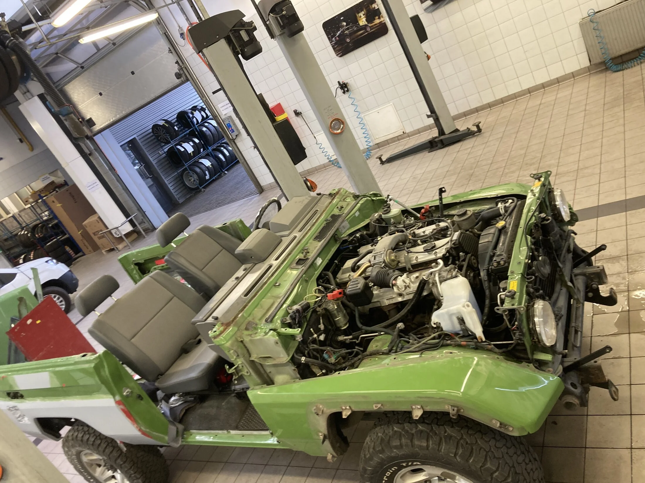

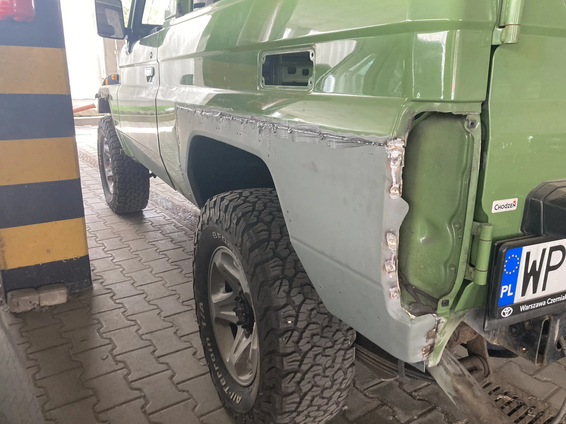

About a year ago I got my HZJ 74. Bought locally in Poland but originally from the Netherlands. Mechanically the car was in a good shape but suffered when it came to the body work and rust, especially on the rear wheel wells which were rusted all the way through and the rear bumper which was disintegrating.

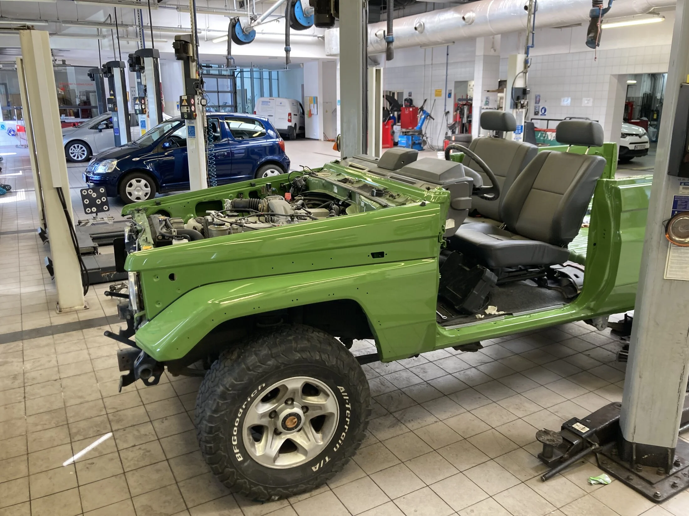

So some fixing was in order. I took it apart, the body shop replaced most of the rear panels with ones from a j71, As j74 panels are extinct.
With the rust removed it was time to strip it more and to paint. Which was fun.
