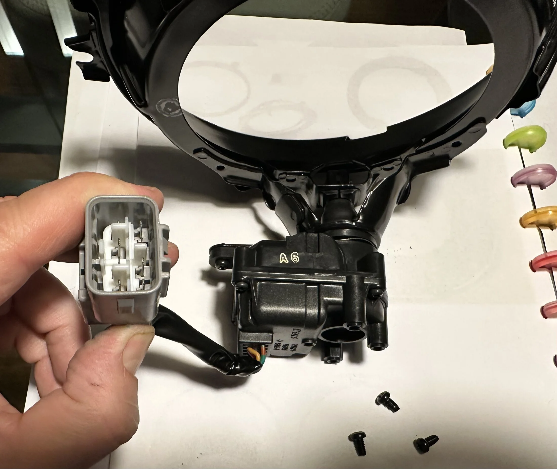

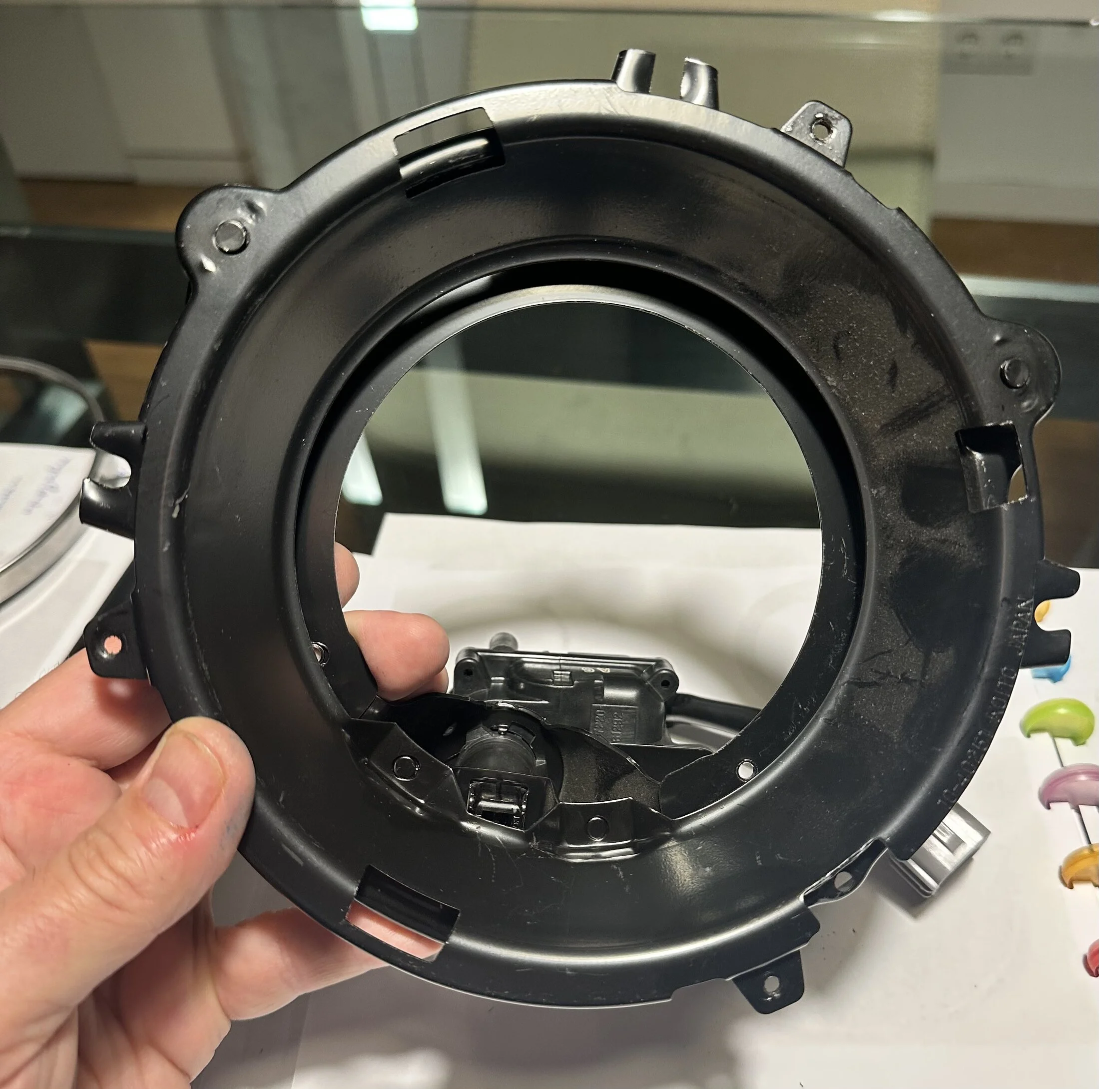

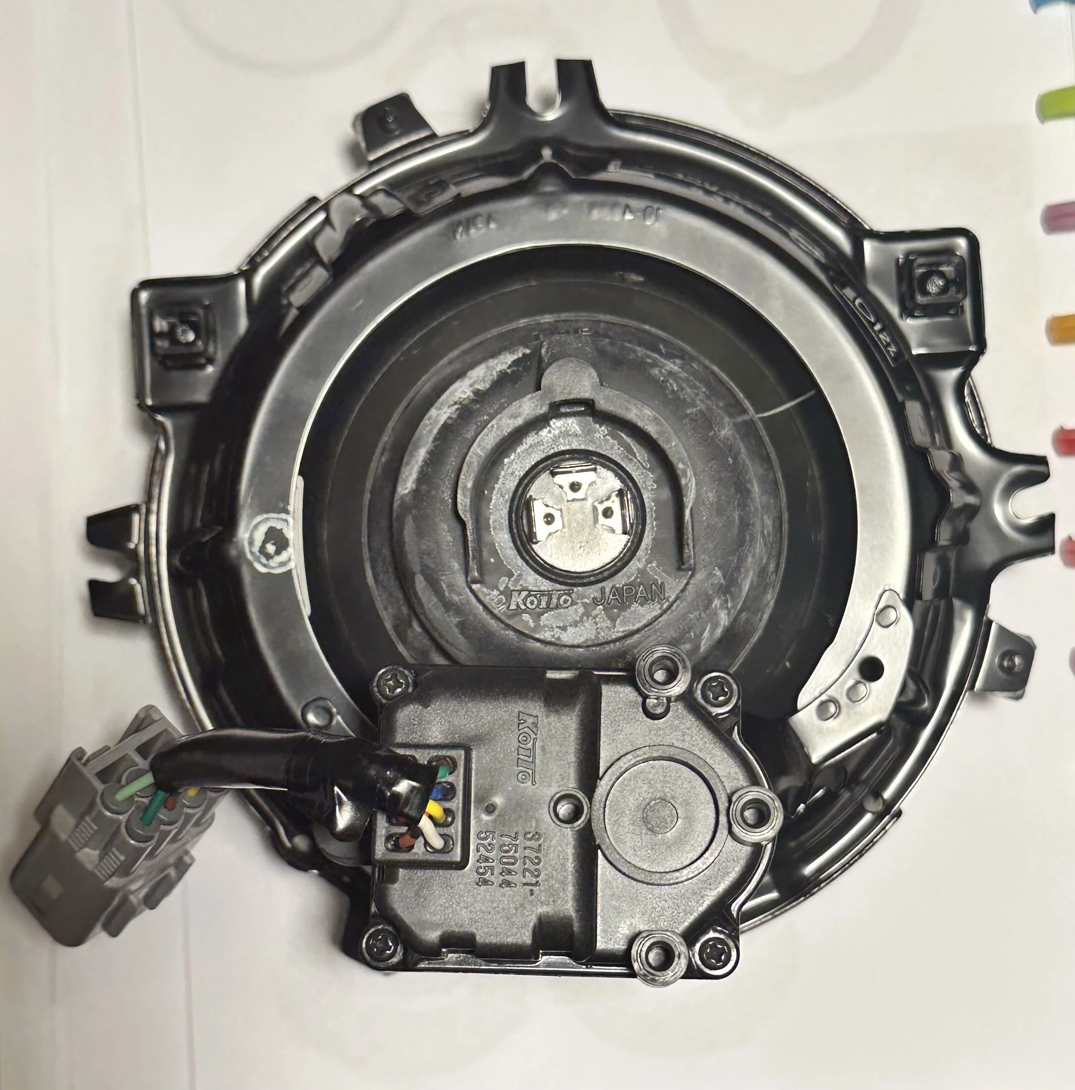

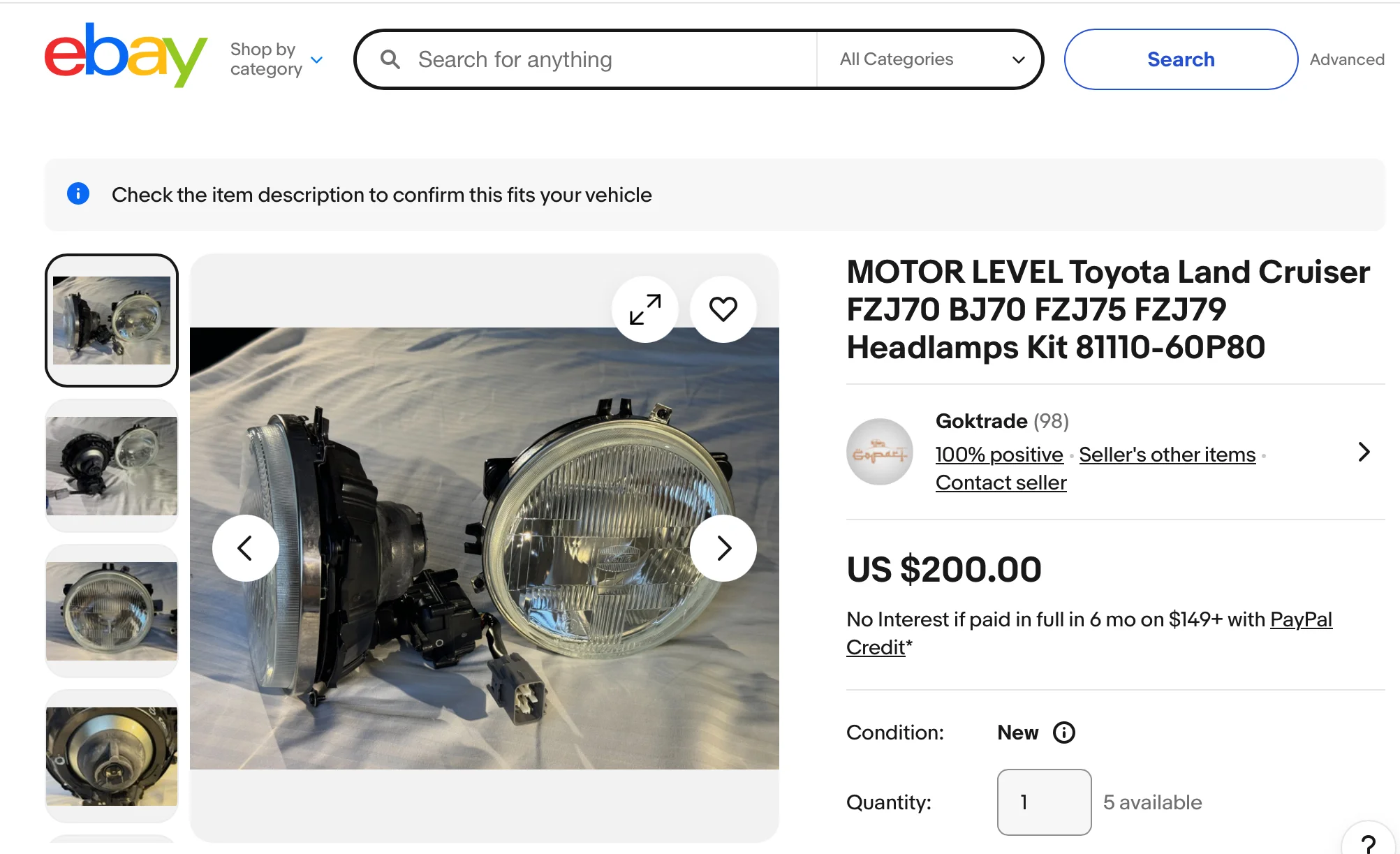

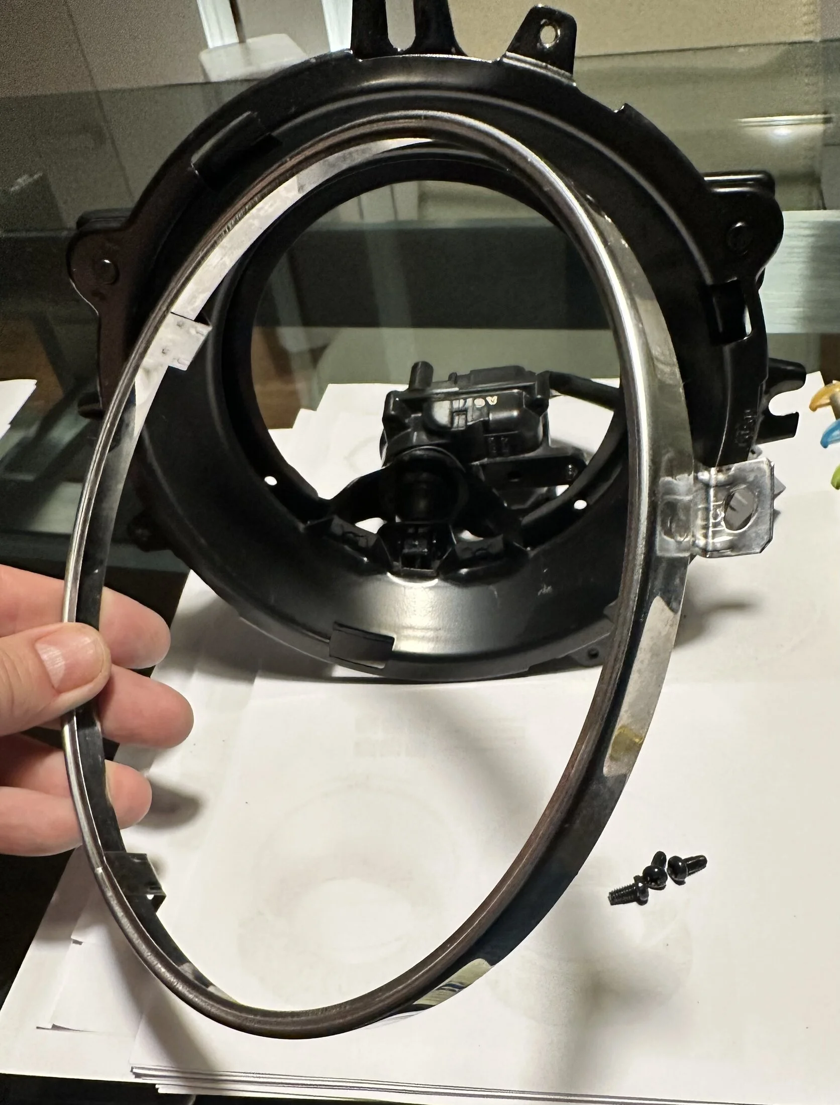

I want to restore the original headlamp leveling system for my European HZJ74.
I’ve spent one week studying the subject.

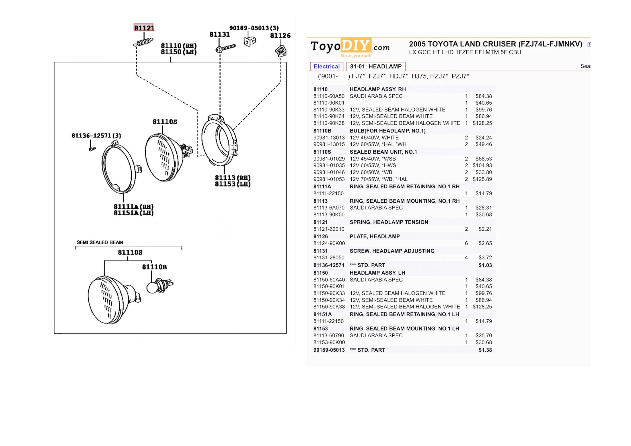

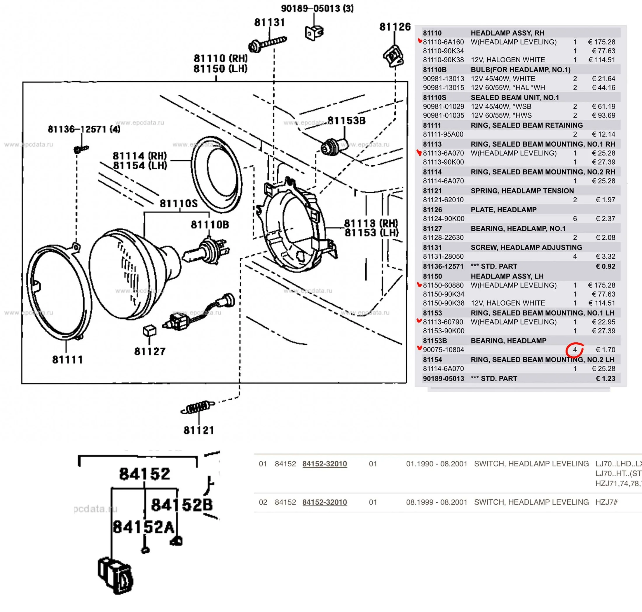

The big issue that all parts from this headlamp is NLA
And not too many LC had this leveling system. Even less had the round headlights
What is interesting, that the catalogue doesn’t show the part number for the leveling…
The latest virsion was for the FZJ71/74 until 2007, but the catalogue doesn’t show the leveling headlamp at all
And all part numbers are NLA :(
One week of searching. Looks like the leveling system is only for Saudi versions.
By chance I’ve found the part number for the mounting bracket only.

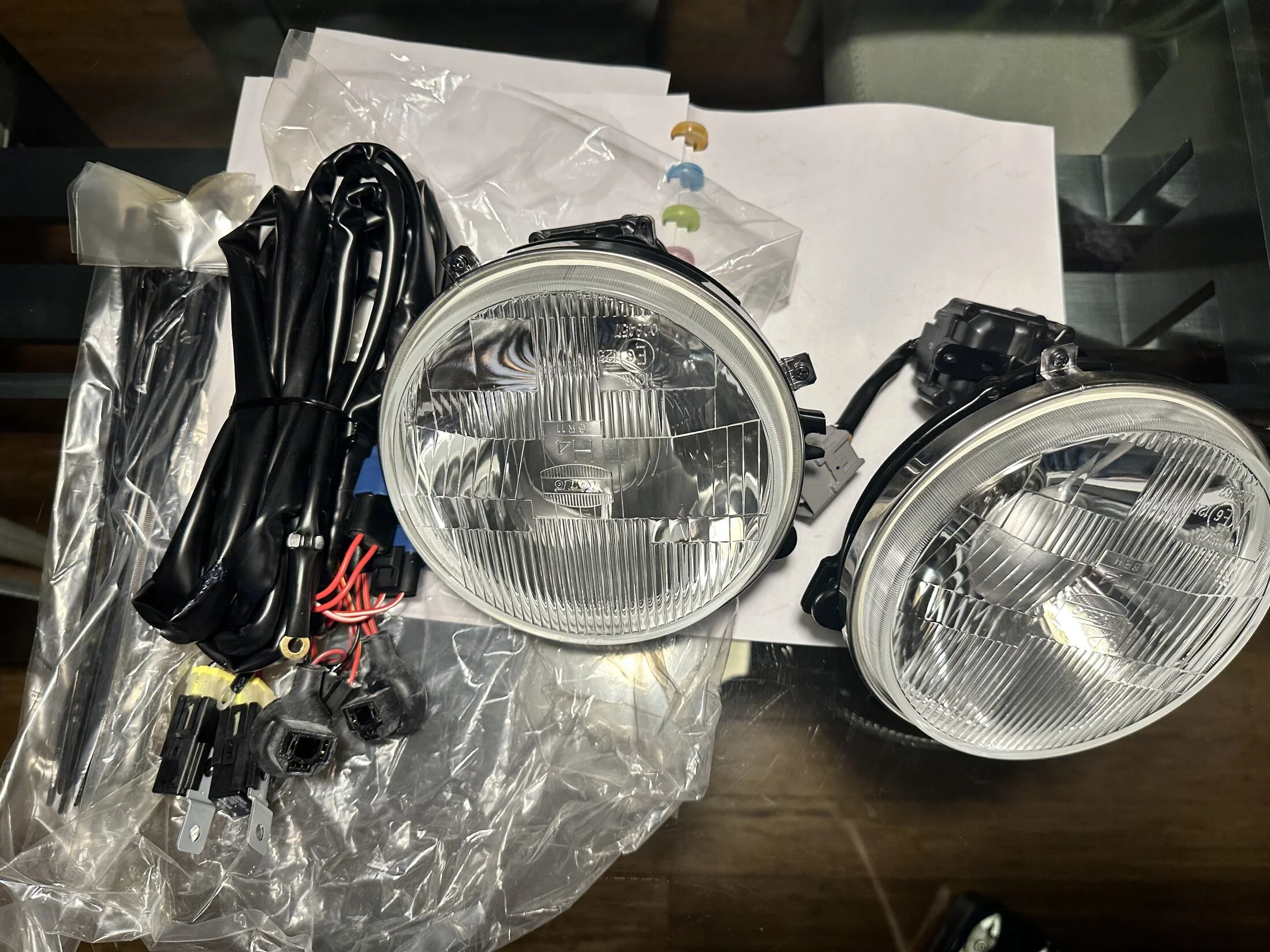

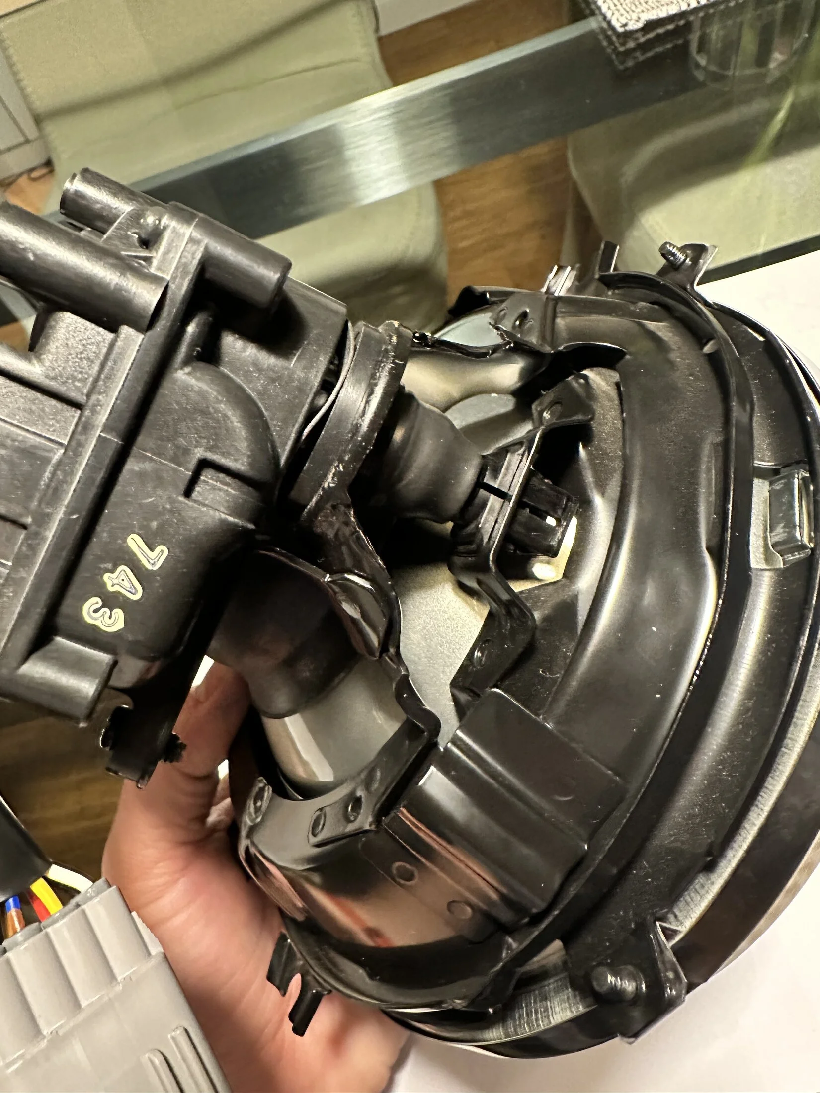

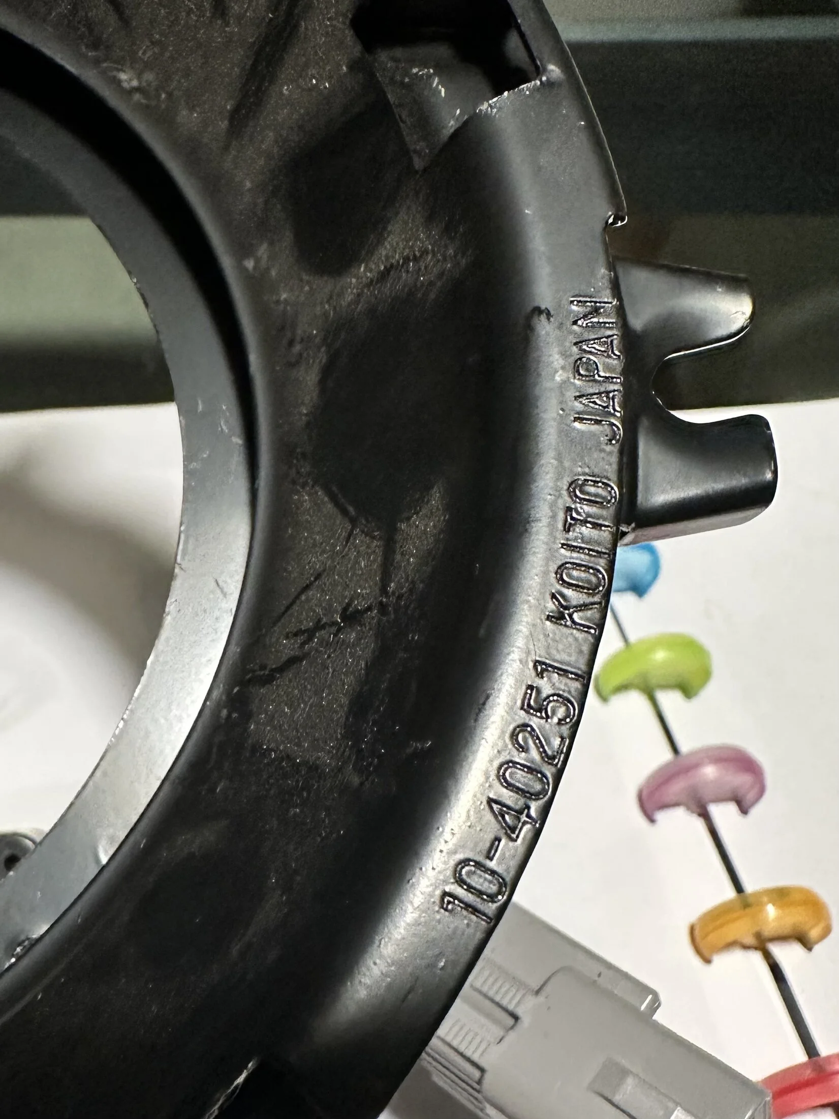

When I received the parts they were too heavy.
Now I know why

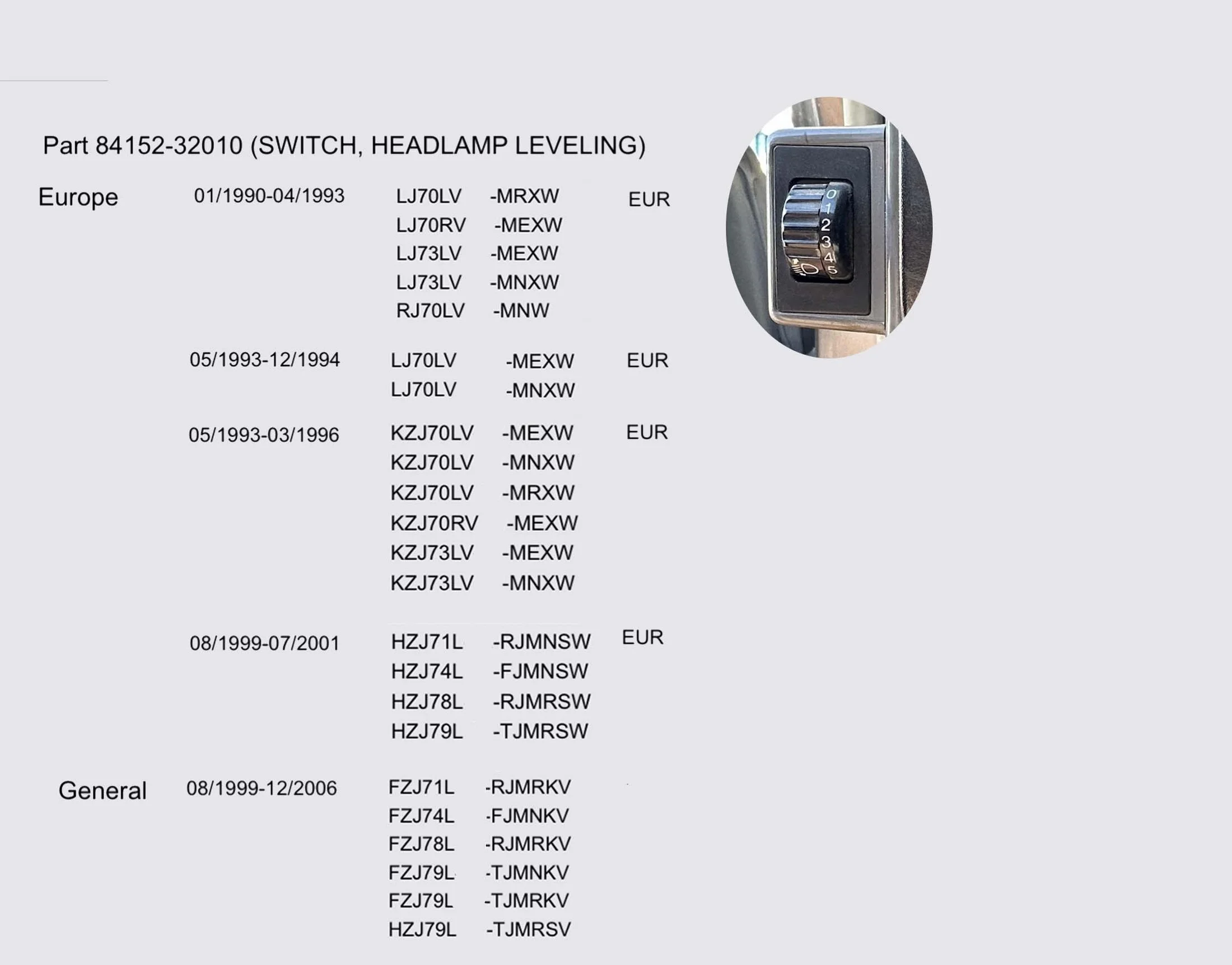

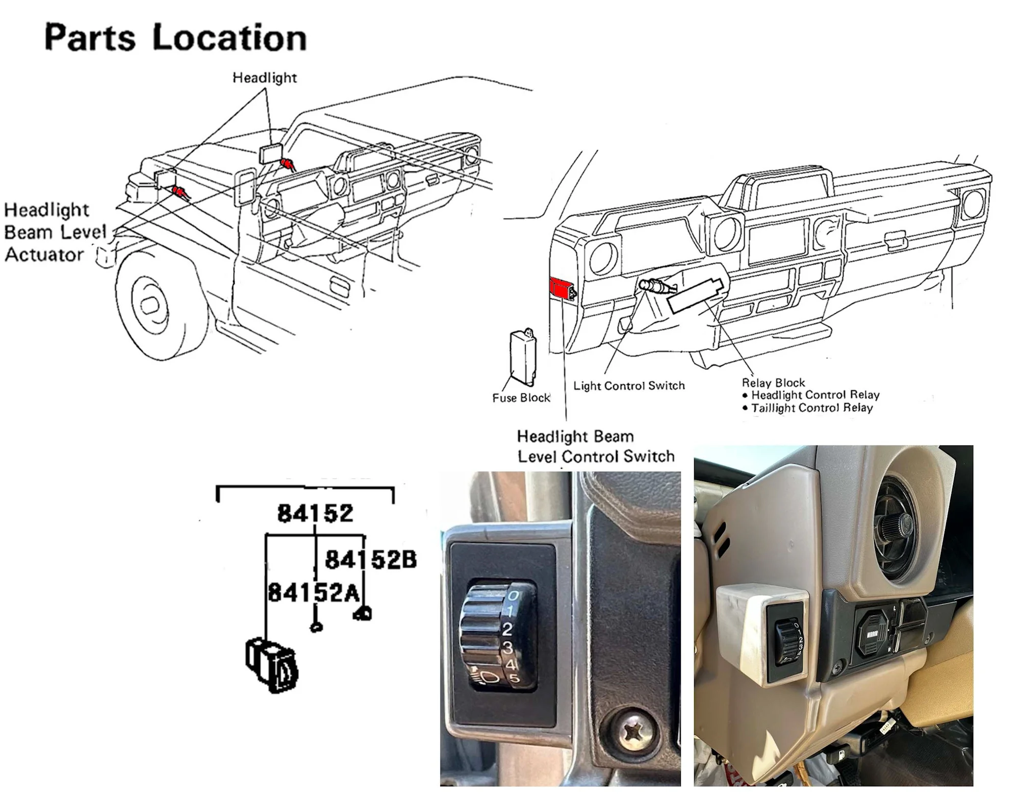

The dash switch seems to be the hard part to get. How does it mount on the dash?
I wonder if the plugs are there in General Markets trucks.
Juan
Hello,
Well done.
Juan
The switch doesn't come with the housing I don't think. The part number for the housing is 55433-60110-B0(grey) or 55433-60110-E0(tan) but that part is long gone. Shame because it could house any kind of switch it seems like.
Hello,
Too bad.
Yes, that housing can come in handy.
Juan
Now I know why
Was the part number 81110-60P70 by chance. I just ordered from my local Toyota and I have the feeling its wrong. Im looking for the LED light upgrade.
I ordered the 81110-60P70 from my local Toyota dealership. They said its was under $30. Waiting for the call to see if its correct.
