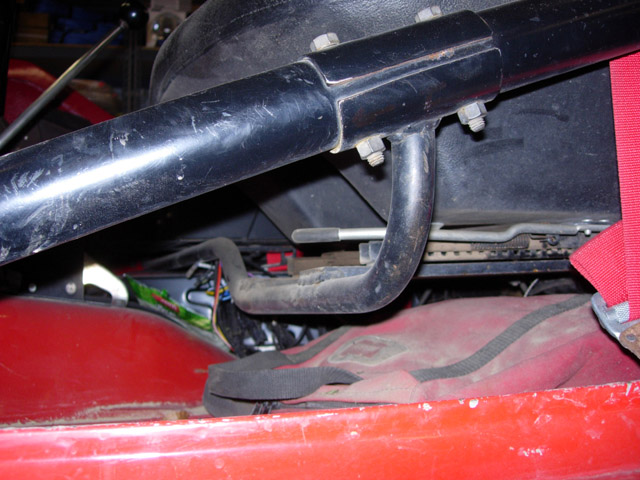

I have a cradle system with a stock tank (16 gallon) in my junk. It is removable, so that you can service the fuel tank or drive line without the cage having to be removed. Ran Baja molded seats for a long time and now run something from Jeggs that sit about 2.5” lower.
Here is a pic. I can get you more if you need them.
