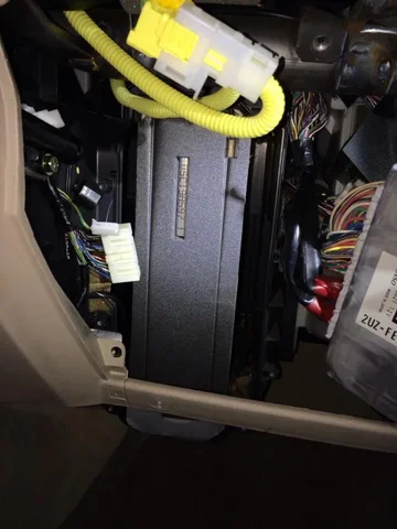

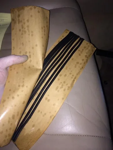

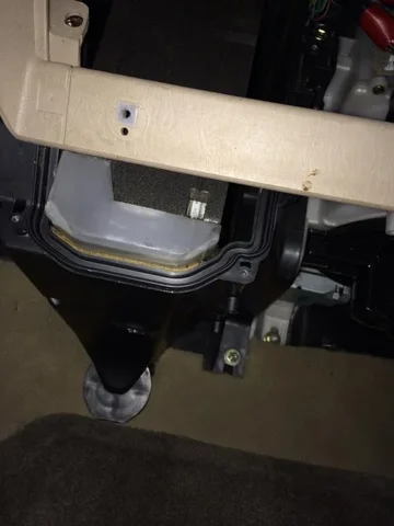

I don't know if this has been covered before. Had a drip every few minutes out of the Hvac case when the compressor was on. Found it was coming out of the evaporator cover. I removed the cover and found an intact yet smushed foam seal. Removed it and cleaned the channel it sits in then applied a strip of round butyl. Put it all back together and all is well. I have pics but it won't let me load them
