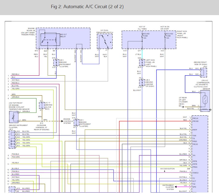

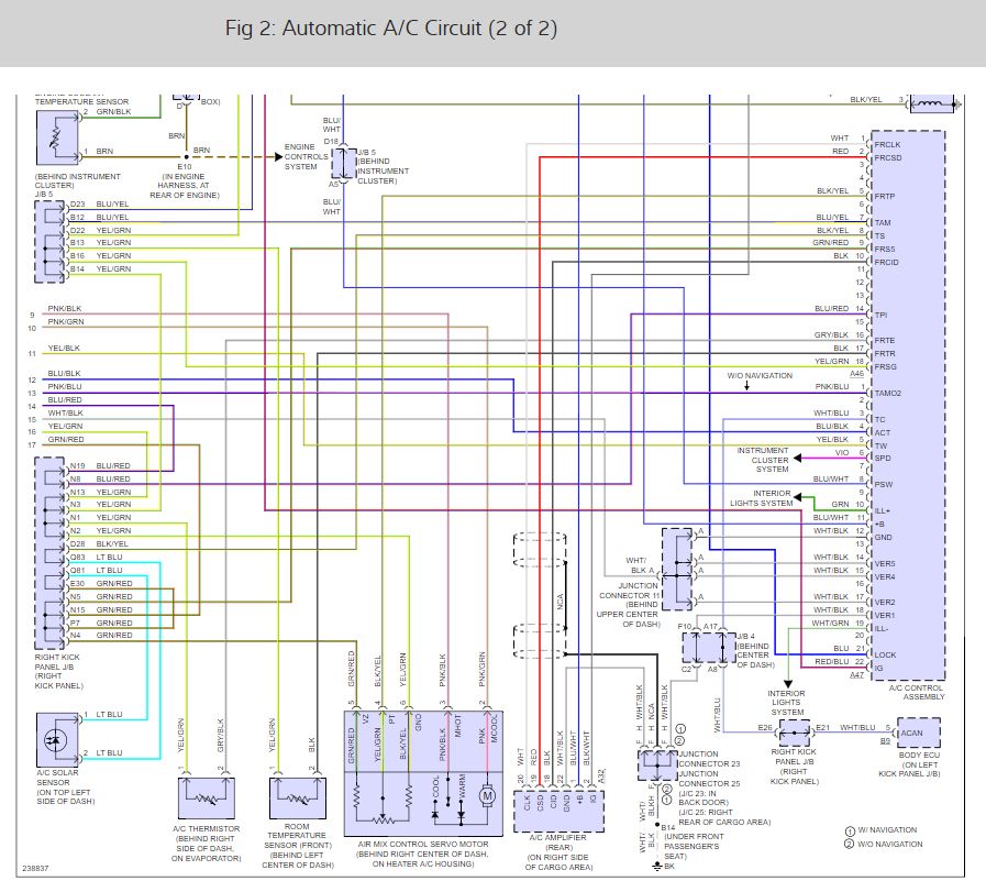

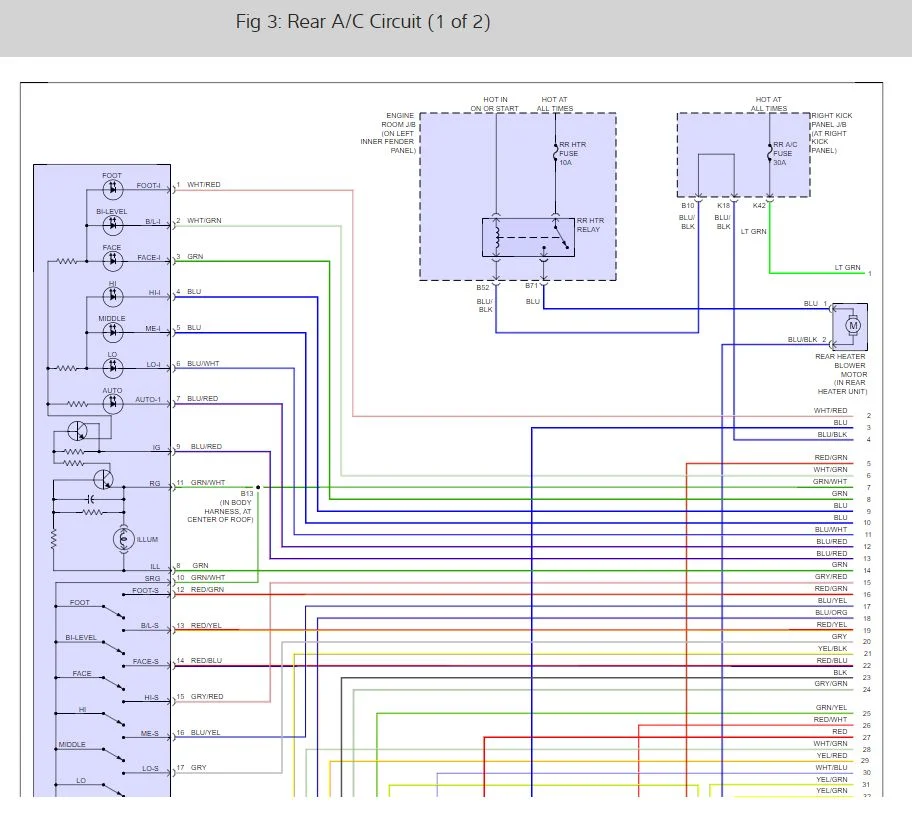

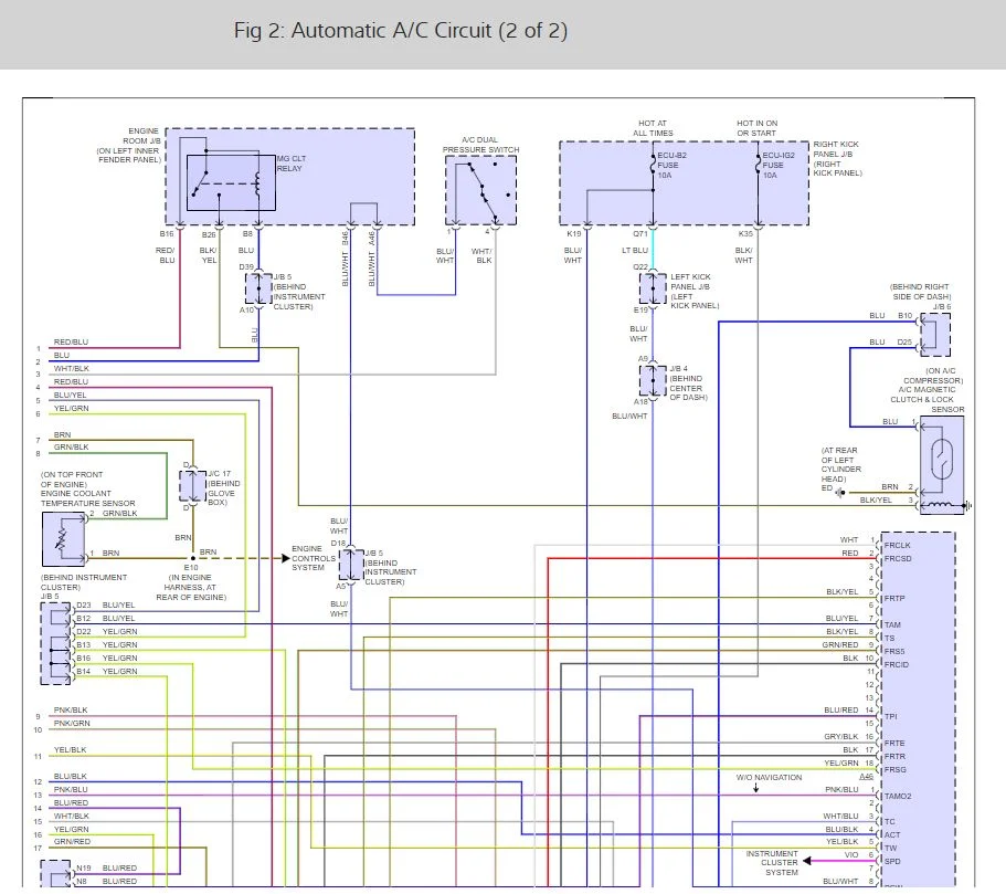

According to the FSM yes, it’s a yellow green. I’ve just been studying the FSM to try to find commonalities to my 8 codes. I’m trying to figure out what body ground A46-18 uses and where it’s located. It passes through multiple fuse boxes so is each fuse box grounded separately? Thanks for the diagrams!
ultimately, under the front passenger seat on the forward seat rail halfway between the mounts. I think there's three gathered up there. All white and back wires. From the air mix, and both ac temp sensors through some other things.
