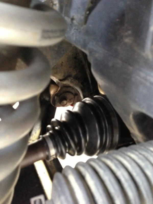

In the DS pre-tear down process, checked out the PS for clamp tightness and spooge a d noticed this
Wheel bearing was loose enough to allow CV to contact the spindle bolt, fusing the clamp to the boot.

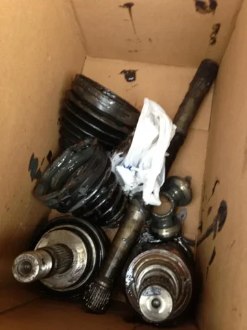

So, after determining that the PS's ventriloquist capabilities exceeded my mechanical aptitude, ordered wheel bearings, seals, rotors and pads (while I'm in there) and tore apart, leaving this
And, finally,
Never crossed my mind to check PS. Wheel bearings were very loose and rapidly deteriorated, based on the indications given in last few weeks ( that I thought was DS CV).
Ordered up another OE assembly, wheel bearings, seals for DS to replicate the process, since failure seem to occur at inconvenient times.
Have been trying to determine how long ago the PS CV swapped, but well over 15k. Probably closer to 30k, so you can bet they'll be checked with greater frequency.
