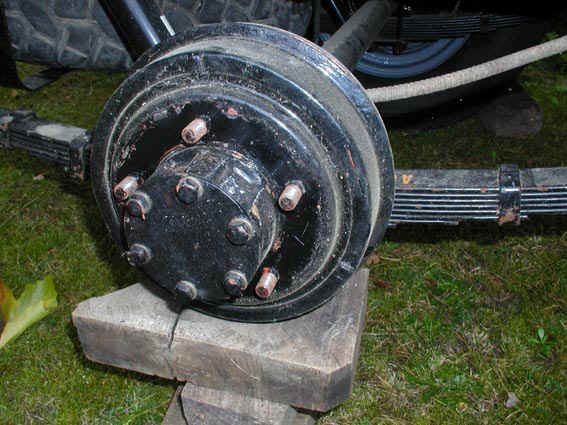

it's easy: see picture;)
before:
after:
Those are conversion rings that were used by the belgian army, because we had Minerva's(LR Serie1) and M416-like trailers.
