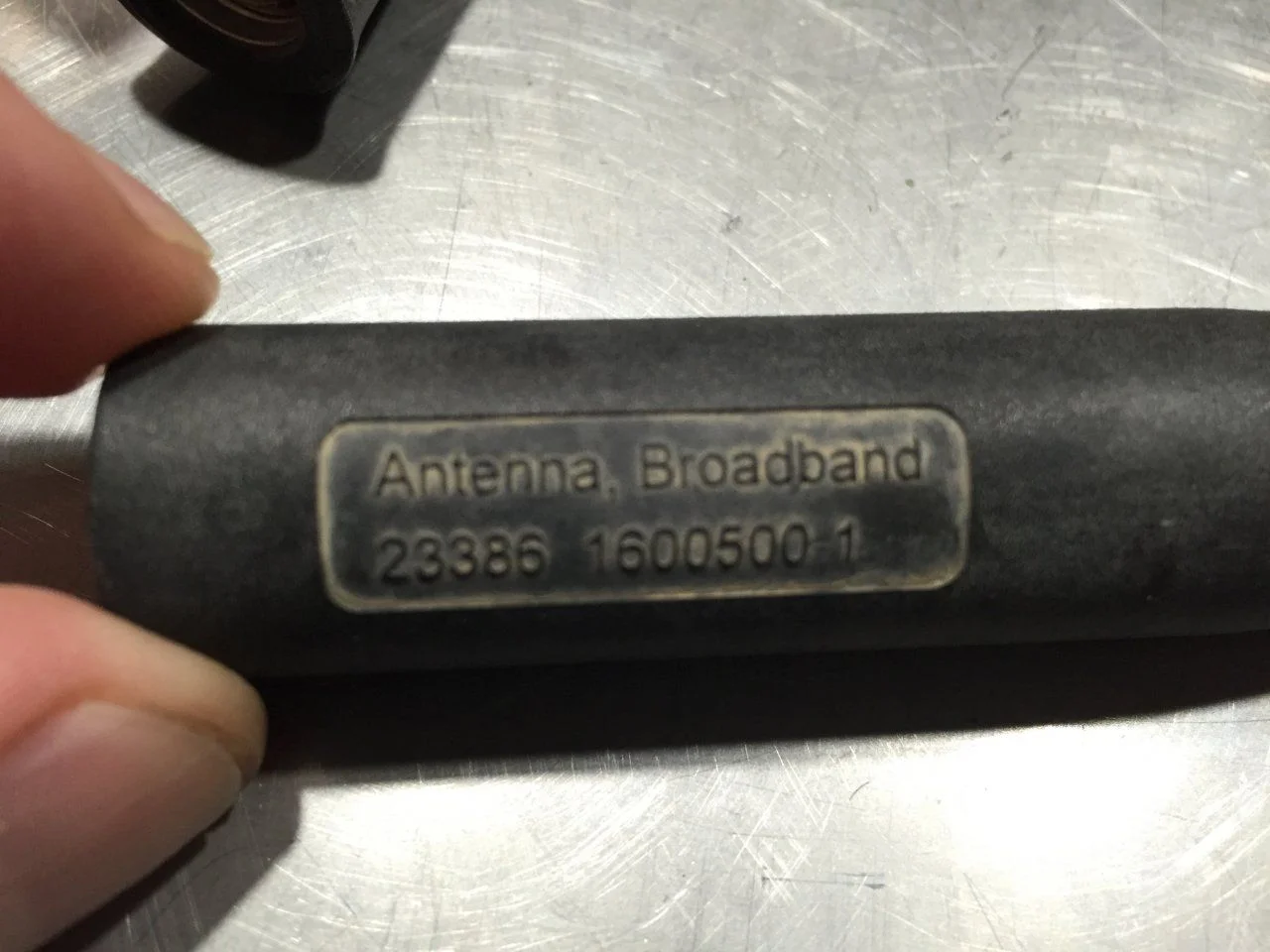

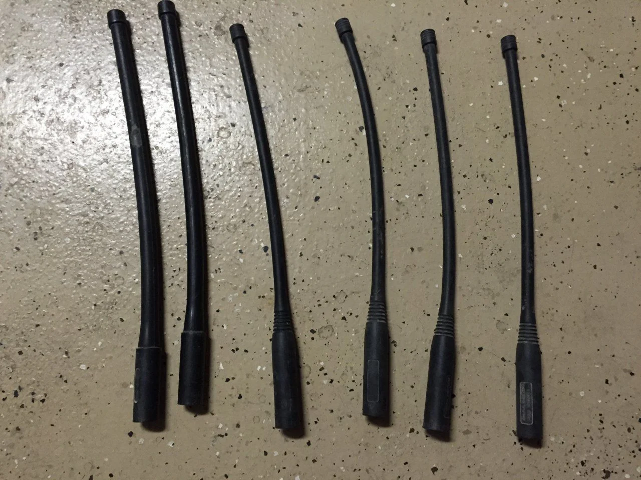

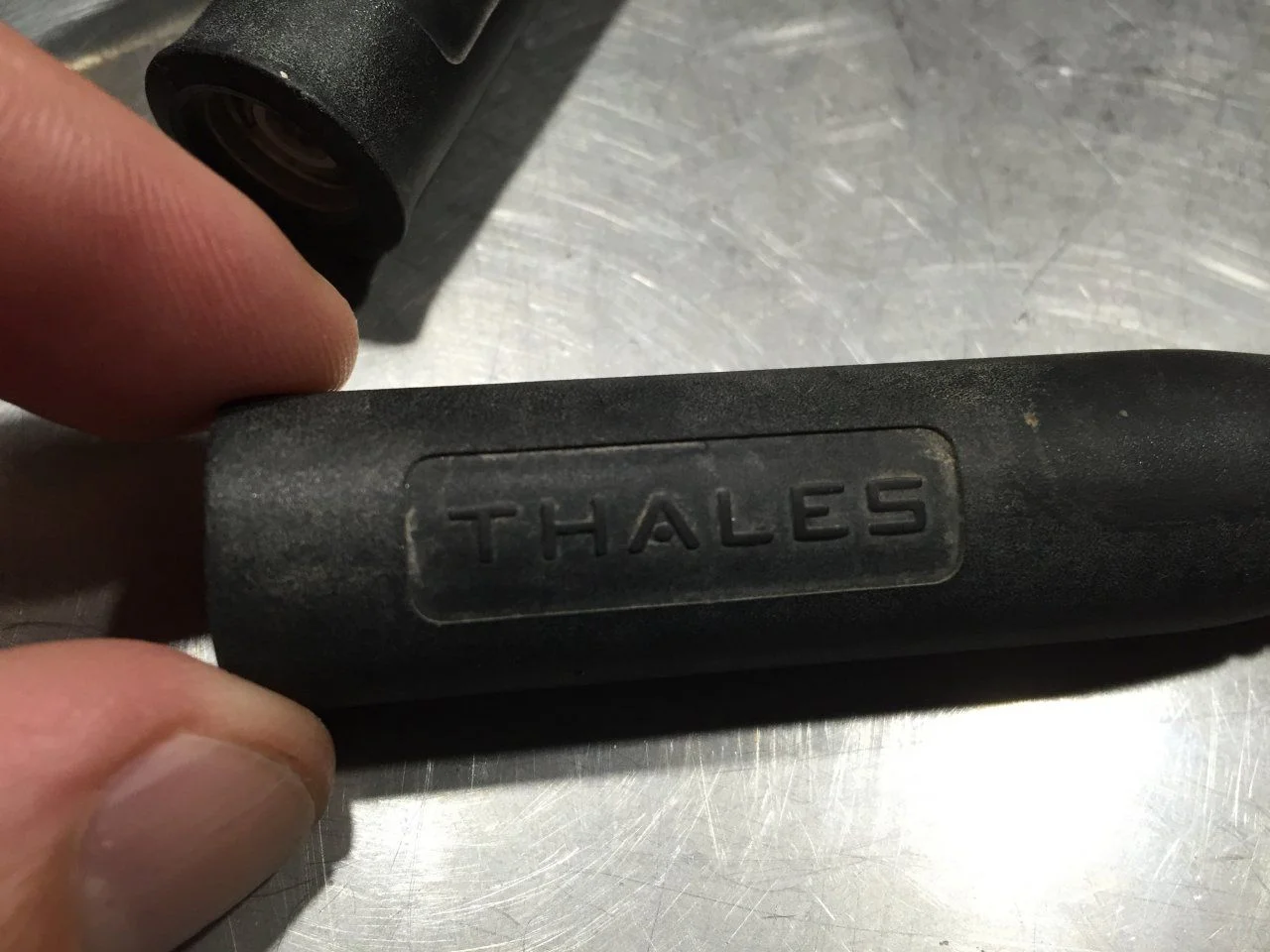

I stumbled across a great deal on these military surplus Thales broadband antennas today at a garage sale.
I am wondering how effective one would be at replacing my stock/OEM antenna in my FZJ80.
Thales: 1600500-1, Handheld, 13-inch Broadband Whip Antenna; TNC connector; 8W maximum; 20 m immersible general purpose handheld antenna providing solid performance for all waveforms from 90-512 MHz.

American commercial FM broadcasts are all between 87.9 to 107.9 MHz., i.e. in the neighborhood of 3 Meters wavelength. so you're going to be on the far low end of the bandwidth the antenna is advertised for. A 1/4-wave antenna for 3 Meters would be about 30" long. That one may still be some fraction of a resonant multiple and it may work OK, but I wouldn't expect miracles.
