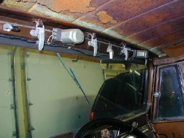

I had a similar question when I got mine, I had the roof and the right windshield, but was missing the hooks. Someone was kind enough to send this photo to me.... It should show you the way it goes (assuming yours is an old one; I am not sure the 70s versions attached the same way)

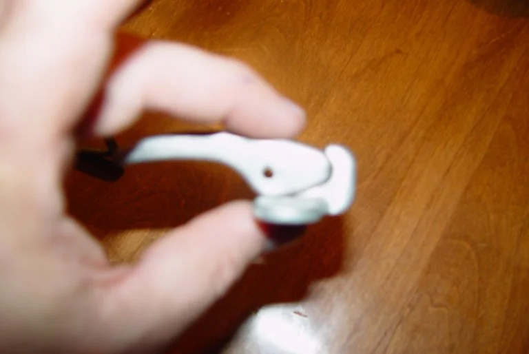

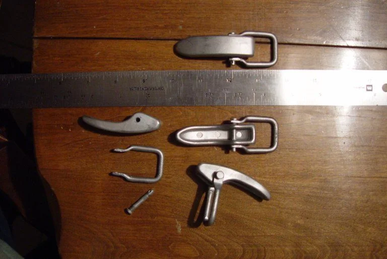

Here are some photos that should show the whole hook thing pretty well. The one that is disassembled shows how you take it apart to attach it to the roof panel, that pin slides out so the loop part can go through the roof, then it gets put back in.
Much respect
Tanx you ...soooooooo much!!!!!!! Now i have to make them . .... And keep me up date whit your projet . I'm gonna open a post for mine. I've got lot of pic. French men from Quebec. and where did you get (always on pic) ih8mud.con my pic don't get it . that's not a big deal?????????
