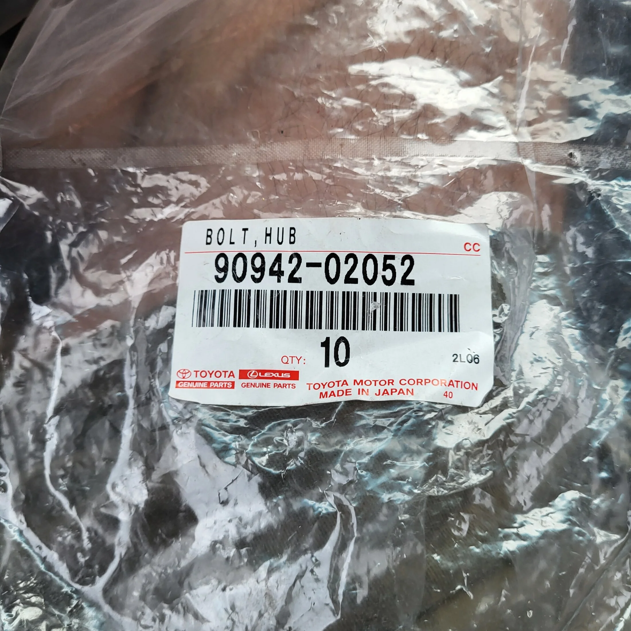

Rear wheel stud part number for future reference.
