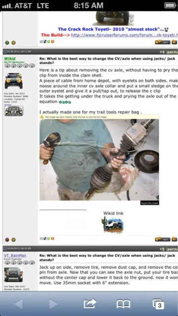

Prying the axle out of the diff will go easier if you use two pry bars simultaneously at opposite sides (ie, 9 o'clock and 3 o'clock).
I tried looking that up last time this topic came up and could not find any pics or video of it. Got any leads?
Pic posted by Puulboy on FJCF
Thread whore Old Cruiser's implementation of above
bellydoc's version using slide hammer and band clamp
Cable works well, just needs to be tight around the axle, in the notches.
When I did, was on lift (installing LT) and the first axle shot across the shop floor using a sledge. They just pop out.
