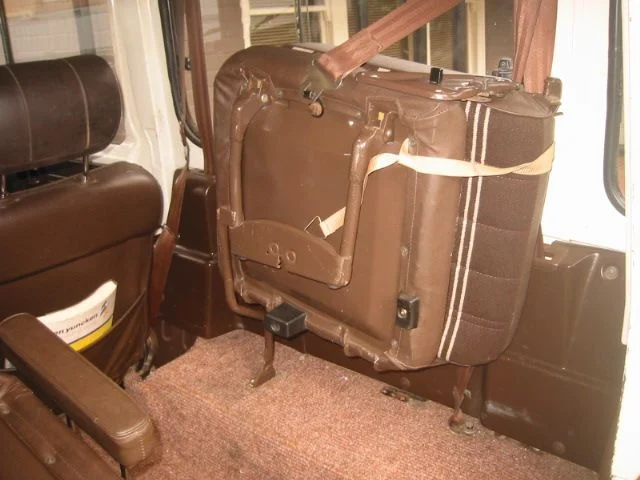

Wow, never heard of a 40 (42) trimmed with anything. Although I've never seen an '84, let alone an LX! I'd like to see pics of how it's setup myself.
I can take some better photos if you want, but these are ones I had on my hard drive.
Wow, how civilized! Even shoulder belts for the jump seats, which appear to be forward facing.
If you get around to it, I'd love to see more. I guess top removal does get a little more involved with one of these.
It does, but it is still worth it. The worst part is getting all those little plastic pins out without breaking them. There is also trim around the front which has to be removed to get to the bolts which hold the windshield to the roof.
Here is a photo of the rear forward-facing seats. I actually prefer the old-style side saddle ones, as they fold up better. The long one is bolted to the floor, and you have to unbolt it and remove it in order to load anything in the back. I often run with just the smaller seat installed, as it folds up and out of the way.
