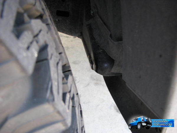

When he pulled into the driveway, it was evident the tires were rubbing the mounts and here's what I saw
And when the wheel was turned it was easy to see the contact

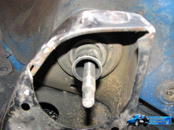

Here's a shot from below of how huge the body mount is from the factory, you can see how much area the tire was rubbing along the bottom of the mount
and from the top... these are obvoiusly the "before" shots

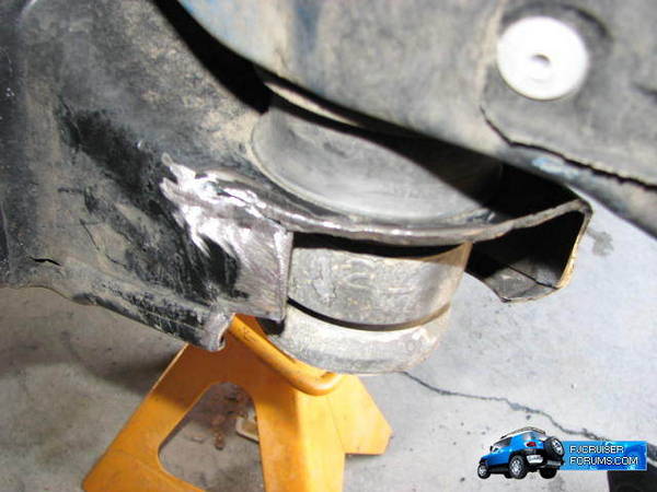

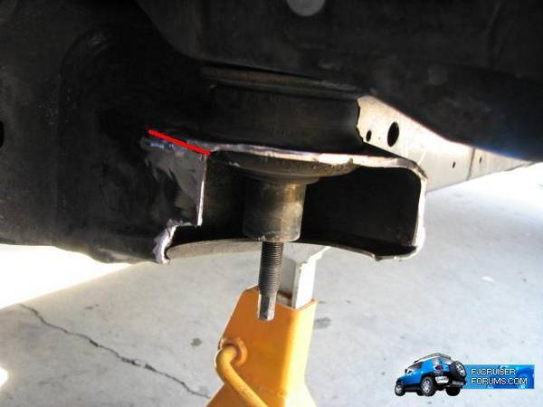

Now we cut... I always wonder whats going through the head of the person watching me cut on their truck. I look at where the most forward edge of the bushing is and mark the mount about 1/4" in closer to the frame (this is more than you would need to fit a 33x12.5 or "305" tire, but this allows adding a 35" tire later if desired.) Then remove the bushing and cut up, over & down the back, following the radius of the bushing cup. DONT CUT INTO THE BUSHING CUP, CUT AROUND IT! The bushing cup is the dipped part that the top bushing sits in. If you run a 35" tire (I do) then the bottom lip of the mount will rub the tire, so I trim the bottom lip further and knock off the edge with a 45" slice, and round all corners with the grinder. This is the reason I use thicker material than needed. The red line is where I will put a 2" slice in to bend the face in a bit farther - this is the different step I thought about mid job & Jeshua volunteered his truck as guinea pig.
Here's the cut mount with edges ground & cleaned and slice in the top radius
After installing the bushing over the stud, I hammered the flat face under the slice to about 1/4" from the bushing and ground the area to be welded. Make sure and get plenty of penetration, you dont want cracks!

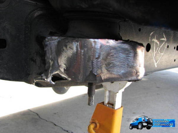

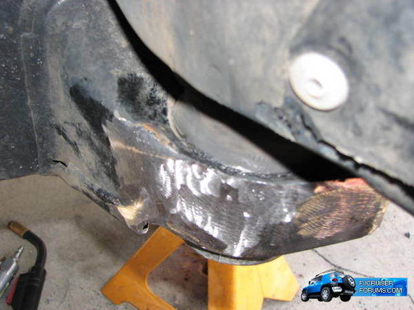

From this point, you can do 2 things, make a cardboard or paper template of the plate to cover the cut, or what I do is weld the plate to the face of the mount on the vertical section, and about 1/2" along the top. Then hammer and stitch it around the radius of the mount until it meets the back of the mount, and finish weld it along the back. I prefer the smooth factory look, so I add material where needed and smooth with a sanding disc - I like the new 3M purple 36 grit ones, they last about 5x longer than the old green discs. It will look like this

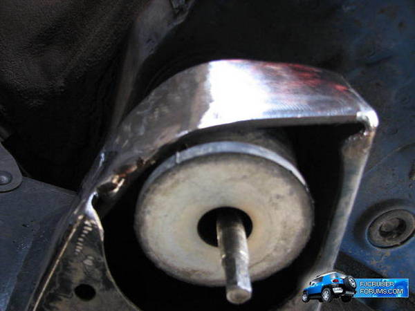

From the top you can see how close it follows the raduis of the body bushing
From the bottom, you can see the upper bushing cup. The crucial clearance areas for the tire are the front to end (9 to 12 o'clock position). Once it wraps past the edge of the bushing farthest from the frame the clearance is inconsequential because if it would hit there, it would be hiting on your firewall too and thats another tech article

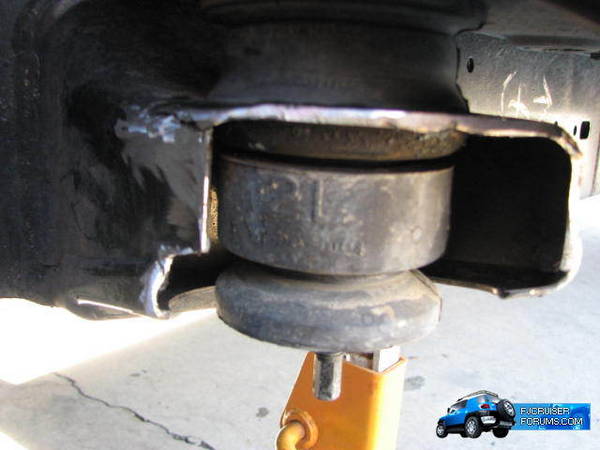

Making sure the bushing clears the new mount face
Heres the finished mount with the bushing installed. If there's a way to get more clearance I'd love to see it. After doing the mounts this way I plan on redoing mine with the slice cut and getting the 1/4" extra clearance, as that will eliminate the slight remaining rub I experience on my FJ with the 35" tires and 17x8.5 rims with 3.75" backspacing

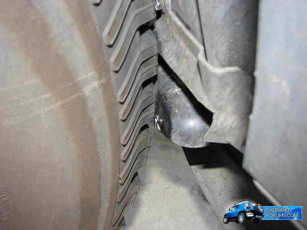

And here's Jeshua's finish painted mount with the 285's installed back on, and no lift
and with the wheel turned - this is the closest the tire will ever get to the mount
With the extra step of the slice cut the total job took 4 hours. But now the FJ has plenty of clearance at the body mount to run bigger tires even with no lift. Its not that difficult and keeps those expensive tires form getting torn up every time they rub. There's nearly 1.5" of gap from the tire to the mount at the closest point now compared to the direct contact prior to the mod.
