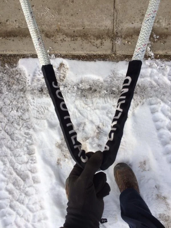

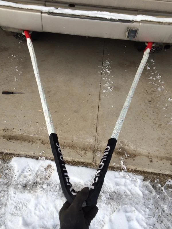

How is this bridle angle....
Jan 16, 2013
162
1,486
Williston, ND
Hoping this is good....experts feel free to chime in.
Sent from DynaTAC bag phone
It's good, but I'm biased. :-)
The part where your hand is should be pointy, not dull. You want pointy. That spreads the load over both attachment points on your vehicle. If it want pointy (the legs were shorter) then they load wouldn't be split 55 or even 60/60, it could be 80/80.
well, if it were the only one I have with me, I would use it unless it would be a scary hard pull. Doesn't look that bad angle wise. But of course the longer the better to avoid inward loads.
