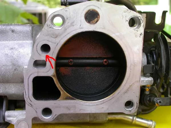

For Doug:
more, these are general Toyota and have a different layout than the 80 but schematically usable.

Raven,
Thanks - that clears up another mystery port for me. Nice diagrams and such.
DougM

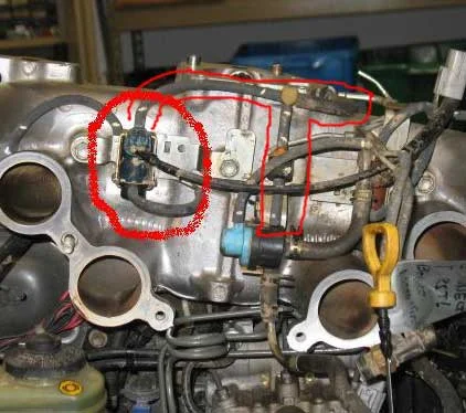

Riad,
FYI the VSV can be removed in about 15 minutes. I think someone (Raven/Beo?) mentioned somewhere they'd done it and posted. I have also. Search for theirs as I wont have time right now to post.
DougM

Doug,
My concern is as soon as I install the new VSV I'm gonna start getting CEL again :frown:. In theory it doesn't make sense but as I read posts from the others with new P0401 parts and CEL, it scares me. As I mentioned before that my CEL has been gone for few days now and I don't wanna touch it if it is not coming on again. Removing the VSV is not an issue for me. I have seen B's post before about removing the VSV without removing all the other stuff (Thanks Raven for that link anyway). I would also like to replace all the little hoses under the intake as they are pretty hard now. I also got some hoses from Dan so I am thinking it would be easier (or wise) to take the intake off so I can keep track of all the hoses (i.e. what goes where). I have a tendency of losing track of things :). Anyway, carry on. I really hope you find a concrete solution to this :cheers:.
