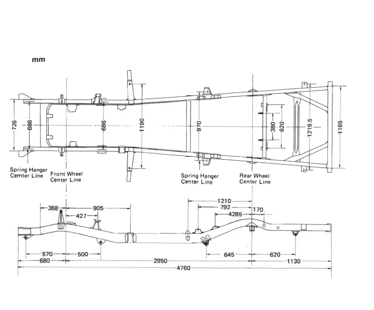

This is what i have as a frame dimension for the 45 series.
As you can see, the part between the wheels is the only part that can be cut to shorten the chassis, but this section is not parallel. Therefore you cant just cut it and re-weld / rejoin it together. Surely you would need to add in another cross member. Or am i missing something????

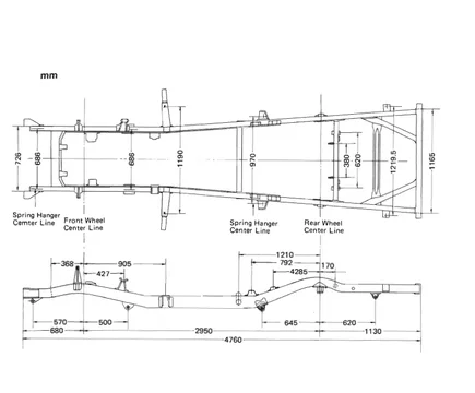

They are not the same and will require a considerable amount of fabrication.

Frame cutting I have seen should be cut at a 45 degree angle and yes fish plates as think as the original material about 12'' long.
