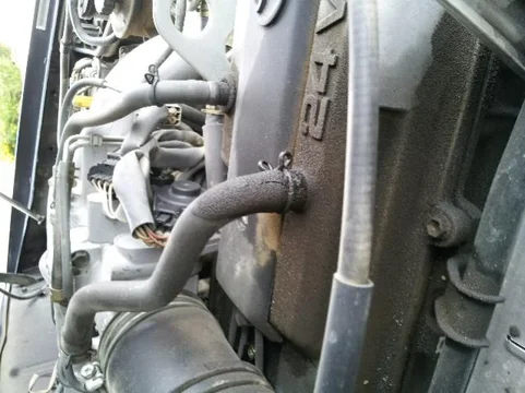

Looked under hood and noticed this ....
Just noticed pics are vertical. I am currently mobile and will fix later.
Looks like you just need ot replace the No. 2 PCV hose with the big crack in it that is allowing oil to seep out. I would replace it and clean up the engine to see if you have other leaks.
Also the clamp on your No. 1 PCV hose needs to be moved down onto the nipple of the valve to be effective.
Looks like you need to open your hood more often brotha!;)
Easy fix.. you might also want to go around check to see if any of the valve cover bolts are loose. I know when my VC was leaking about a 1/3 of them were loose enough I could turn with by finger!!
common and an easy fix. i finally did mine, i had the aftermarket electrical tape upgrade for years. buy new clamps too, cause the old ones will be worn
