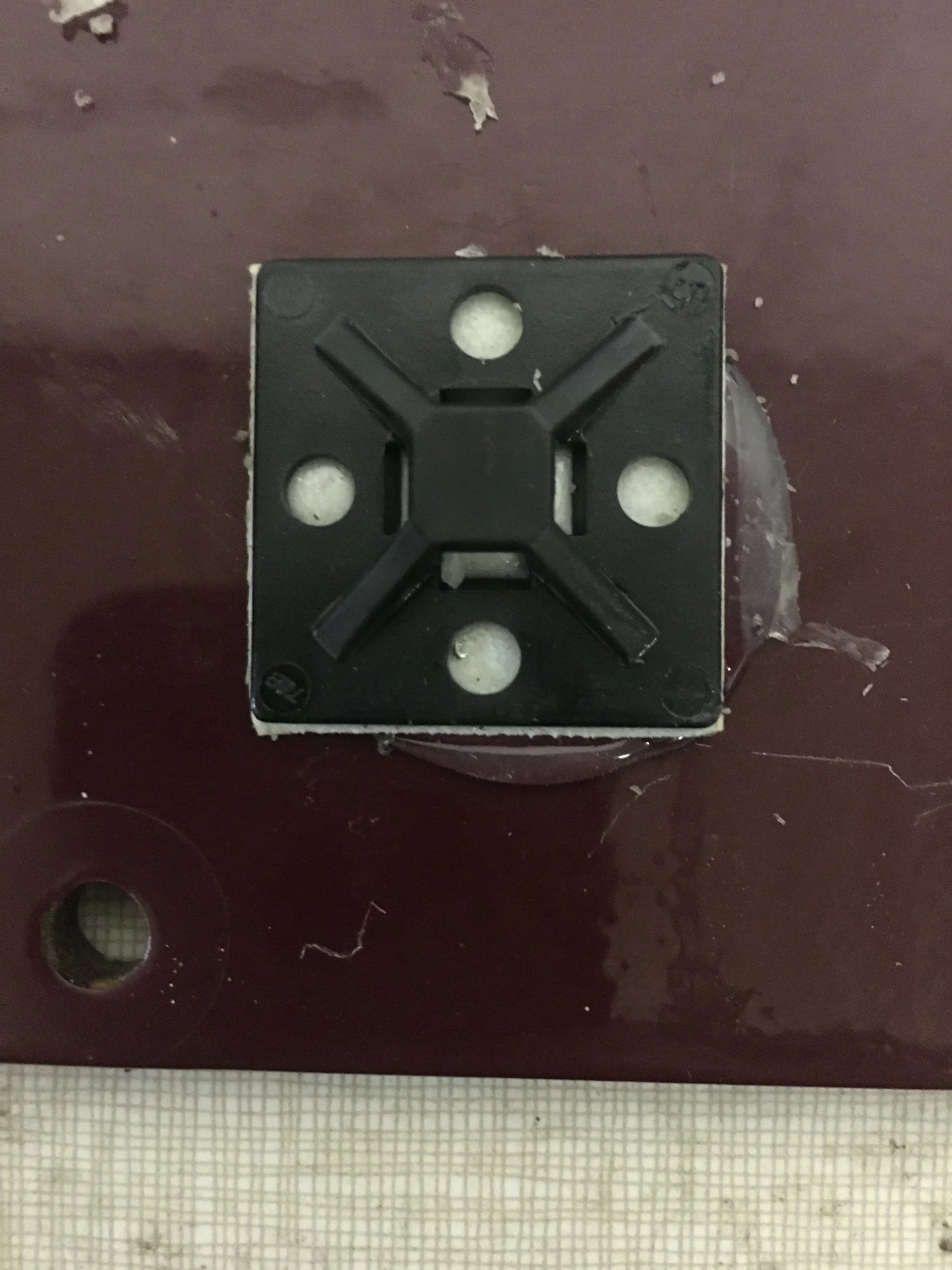

Former auto body shop owner my daily driver beater Tacoma got a nice dent yesterday , rear access lower and running board , I found a brand new set of running boards the access fits 2nd gen to 2020 3rd gen , got a set for 100 bucks good deal .
Pulled most of the dent out with a suction cup but still a bit ugly , back in the day it was weld on studs if need be but hot glue seems to work awesome .
I glued a few sticks to some automotive painted parts ... Sticks like crazy , I’m going to use some wire loom tabs for zip ties and put a key ring on it for pull on the metal while I massage the dent back out .
Anyone use the Glue Technique?
Yes, you're better off buying the pdr equipment specialized for that type of work. I've had good luck working on my own dents. and dents caused by inconsiderate people - what I call incmarks.
Dent time has some good vids you can check out, and get ideas for what equipment you will need to handle basic repairs.
