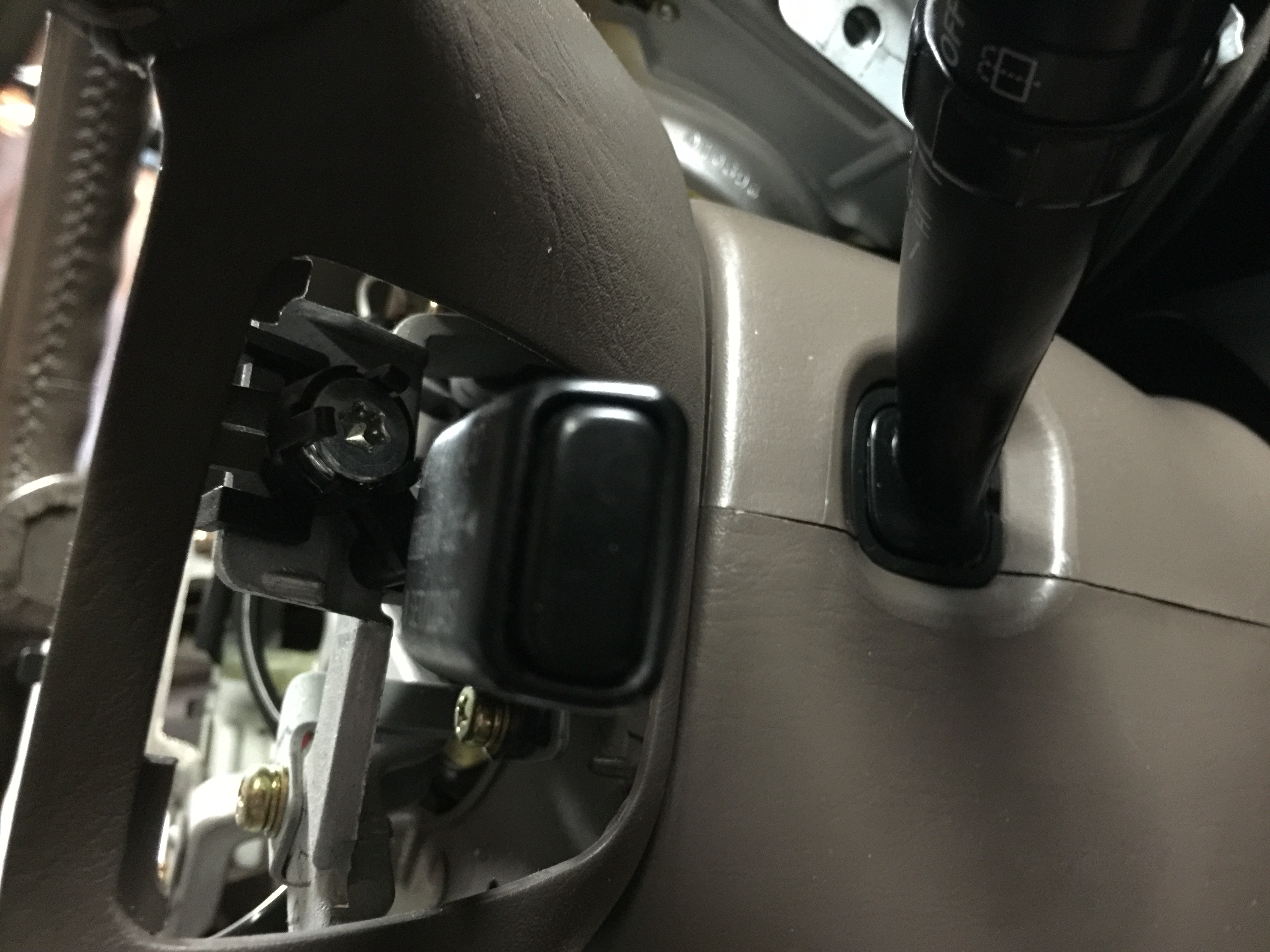

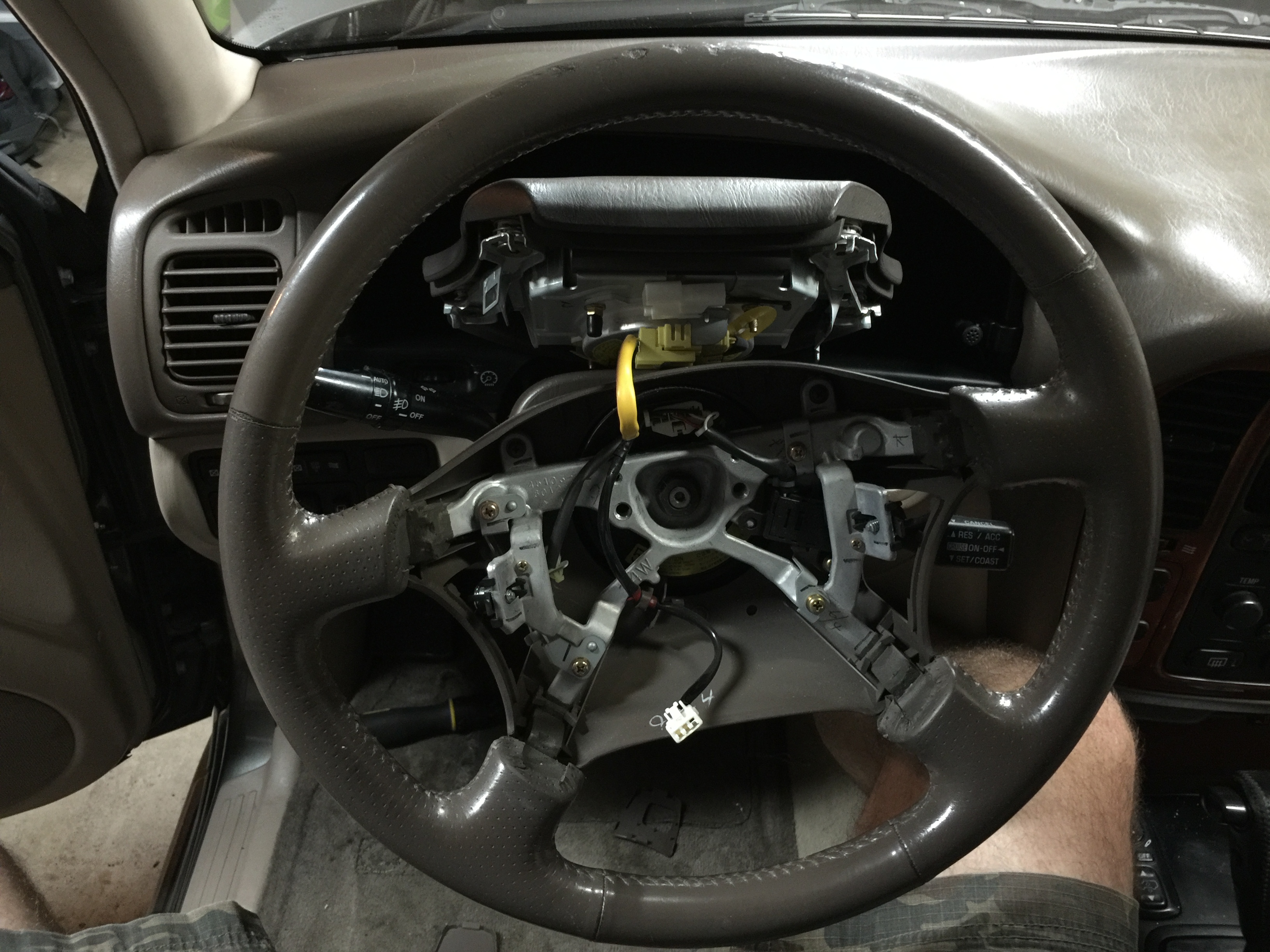

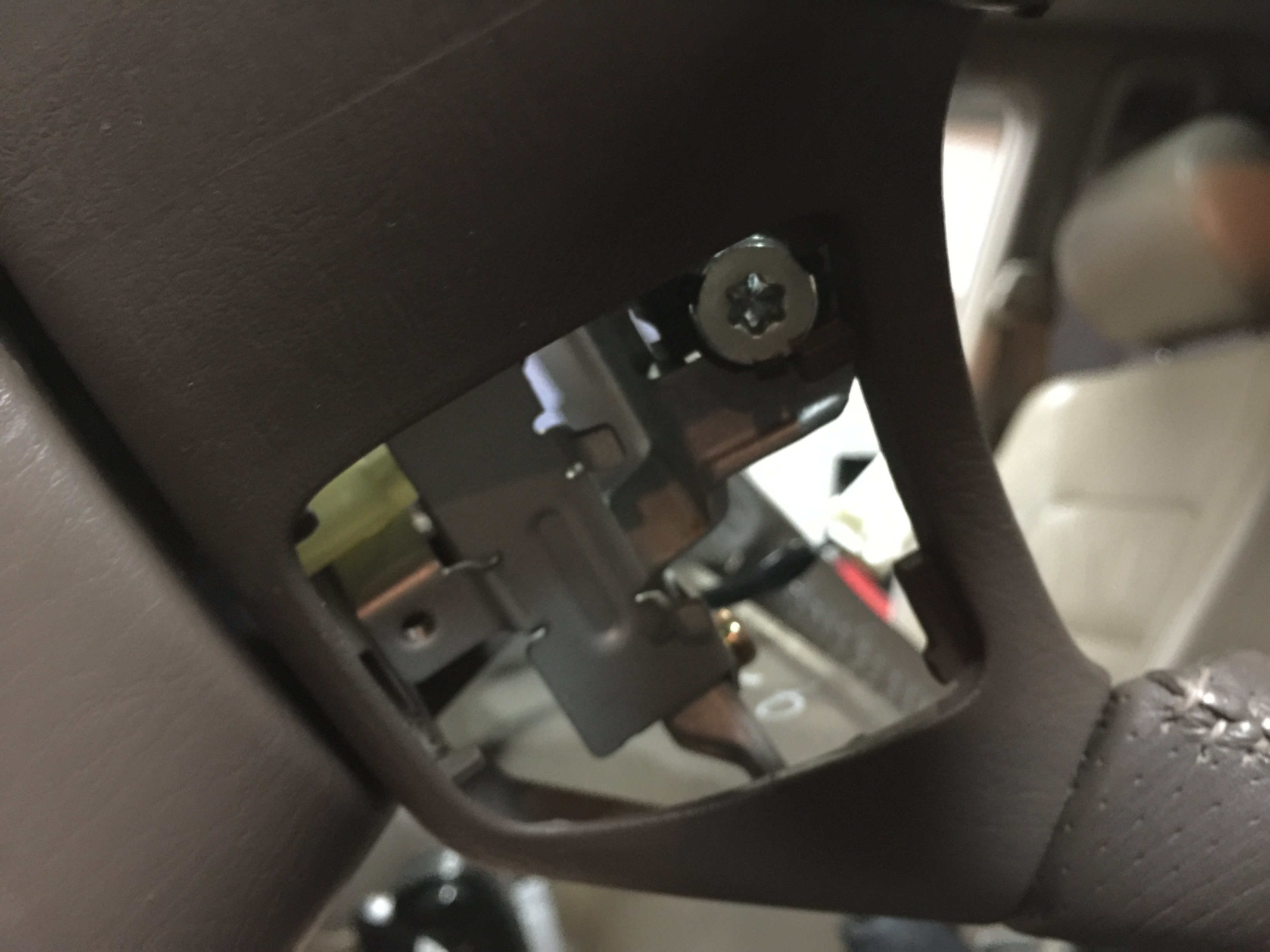

3. I removed the two side panels of the steering wheel with a small flat head screwdriver. Unscrewed the Torx bolt on both sides and popped the horn/airbag cover.
The white plug (bottom middle) is a single wire for the horn to connect to the rocker activators. (This is incorrect)
I left the yellow airbag wire plugged in. That thing made me nervous (I had the battery negative unhooked).

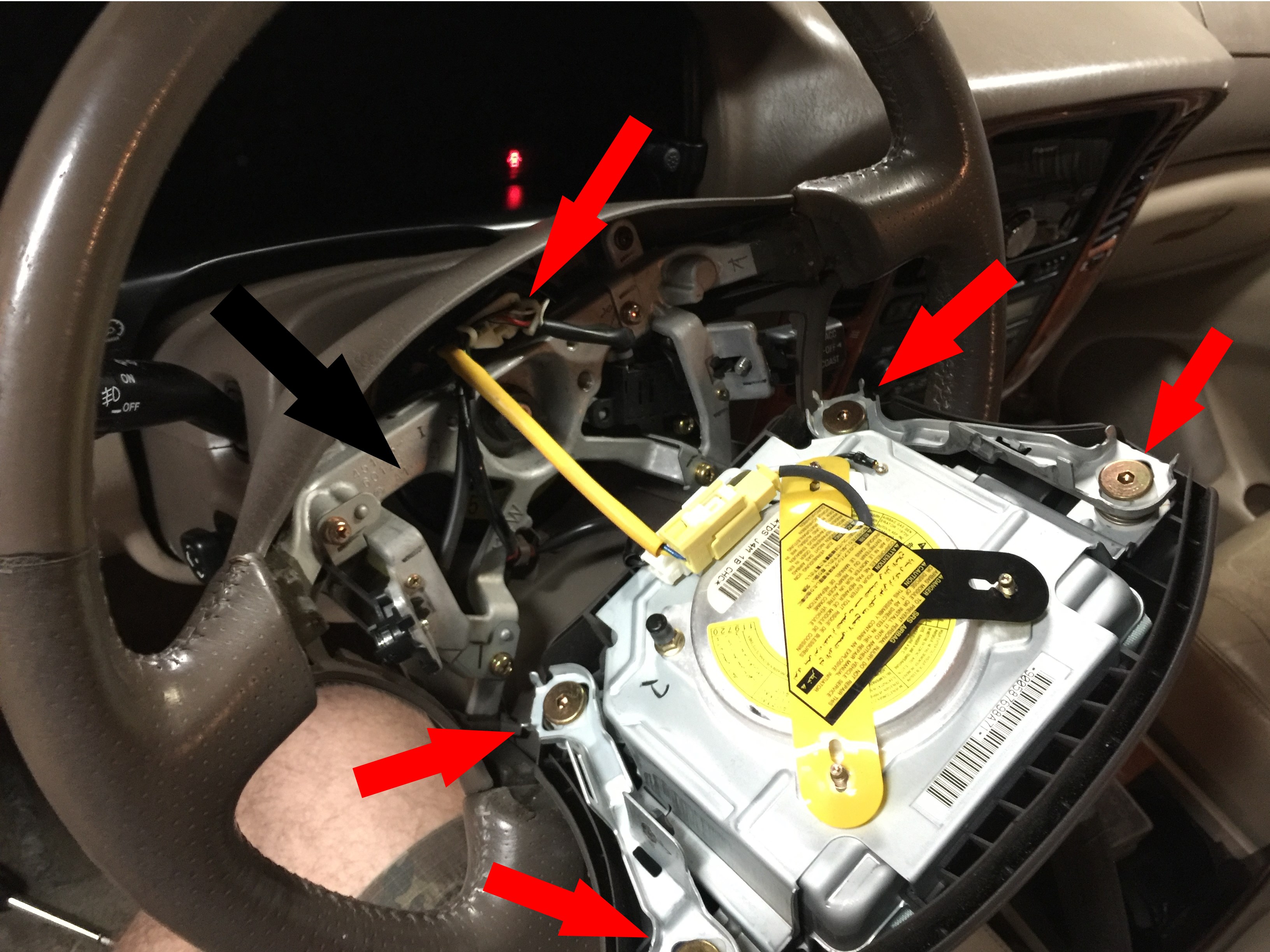

4. I plugged the white plug back in and started testing voltage in all the hot spots. All came back with 12v. So everything was active!?
Here are the locations.
Black Arrow: Grounding point
Top red arrow: Pin 6 (horn+) on the harness
Other red arrows: The four bolts on both left and right rockers.
5. With everything testing out ok, I plugged the battery back in and started putting the steering wheel back to together. All of a sudden, it honked! I got it all put back together and it would honk every try in all spots. There must have been a loose connection or something needed to be reseated. I basically checked, unplugged and plugged back in every component of the horn system.
