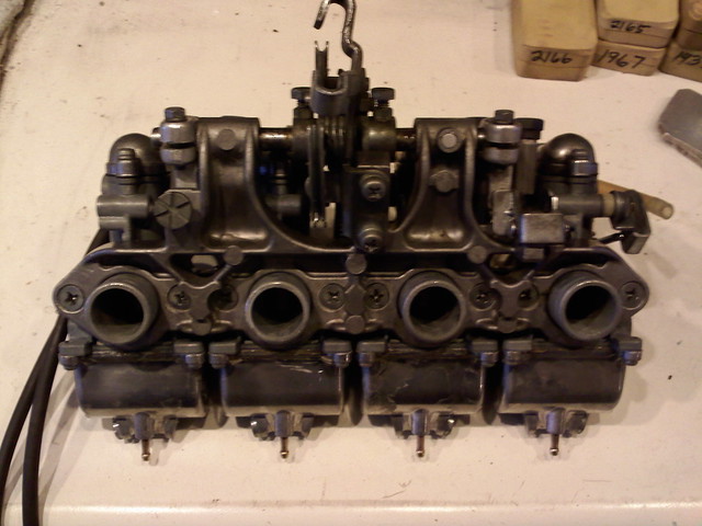

I had to go through the 4 carbs again today, I did it a couple of months ago just to get all the varnish out of them.
This time I was taking my daughter for a ride and I had to switch to the reserve tank, I guess I may have sucked up some crud or something because it ran like complete crap afterwords, So now I need to go through the tank and clean it out well.
I brought the carbs to work to run them through the ultrasonic and check the idle valve, Which is just a small hole in a piece of brass, The hole is just a little larger than a typical wire wheel bristle, So it wont take much to clog it up.
I was having some idling issues as well, so hopefully this takes care of it.

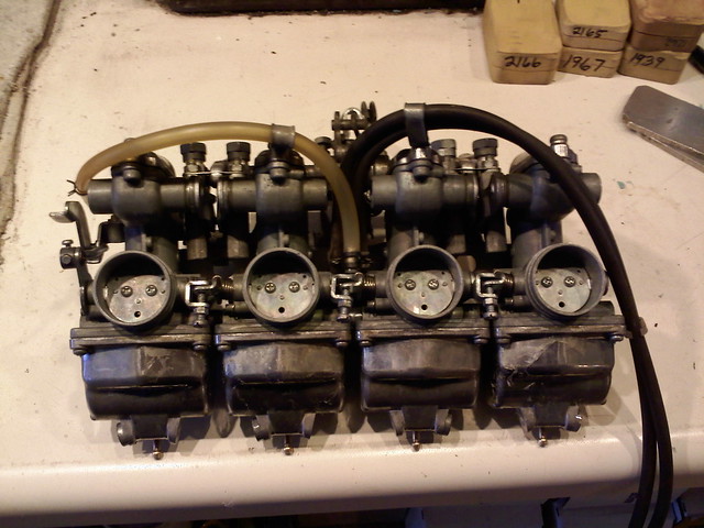

Here are a couple of after pic's, They look about the same as before, I did more cleaning to the inside than last time, Last time I was suggested to use hot water Simple Green, It worked to some degree, But I dont think it will be as good as the ultrasonic.
It also looks like I need to adjust the pistons(I forget what they are called) so thay are all close to the same opening.
Yay me!
All is back together and working great.
I had to re sync the carb's but that didn't take long.

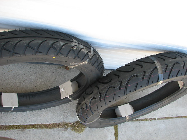

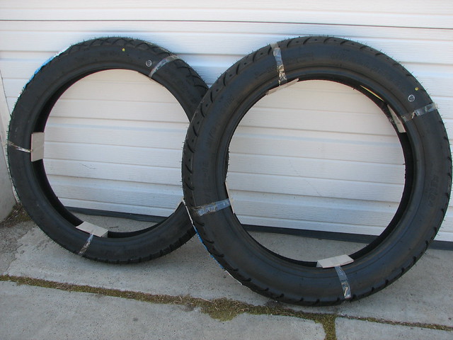

The carbs can certainly be a PITA, But now that I have them in order, Things are coming together, I have a new set of tires in the garage awaiting install, The shop I bought them from will install for free if I take the wheels in off the motorcycle, I don't know if this is at many shop's But I like it.
Nothing too special, Kenda tires, Front is a 90/90 18 Cruiser S/T, Rear is a Challenger 110/90 18, Both H rated(130MPH, Like I'm ever going to see that kind of speed...)
Trying to figure out the new tire size compared to the old tires was a chore, But I finally left it up to the motorcycle shop.
