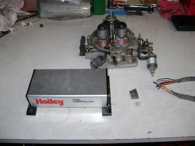

pro-jection 011_Small.webpDoes anyone have experience with The Holley Projection kits? I am having trouble getting the injectors to fire. I have replaced the distributor module (not the problem) and made sure that i have power it just seems like the controller is not sending a signal to the injectors for some reason??? I look through a few threads last night and haven't found anyone with a similar issue. I am concerned that I may have a problem with the ECU. I got the kit with my 40 so I don't know how long it has been sitting in a box or if it is repairable?:crybaby:

So does it have an ECU port, or check engine?
Is there power TO the injectors and the fuel pump? Is the FP providing adequate pressure?
Lastly and probably something that should be done FIRST... Check the grounds!!
RustyTLC once told me that the MOST COMMON electrical failure is poor ground contact.
Another thing (what I ran in to) was the power wire TO THE ECU was cutting out when cranking and thus, sending a no start signal. I tried a different wire that was hot when keyed... Fired right out and ran like it had been running for years!!
Did you pull the fuel line, crank it and see if fuel is coming out??

Nice lots to check on I will hopefully get back up there this weekend to see what I can do in the meantime I sent my mechanic/ buddy your suggestions to look at. Thanks Keith!!

Its official I"m a moron! I had the pick up and breather lines confused to the pump that could explain why I wasn't getting fuel at the injectors!!! This is why I am not a mechanic, I would certainly starve to death:whoops:
