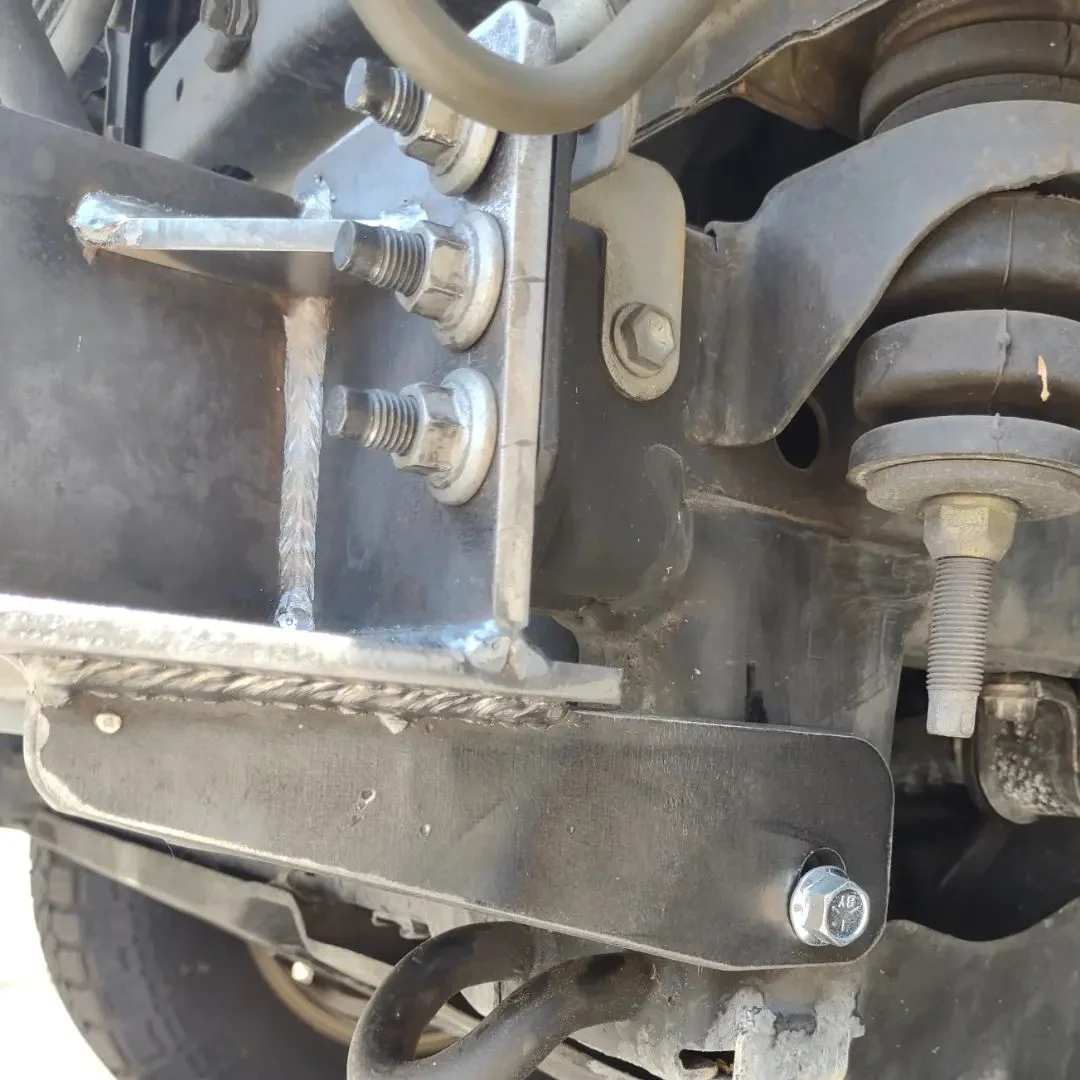

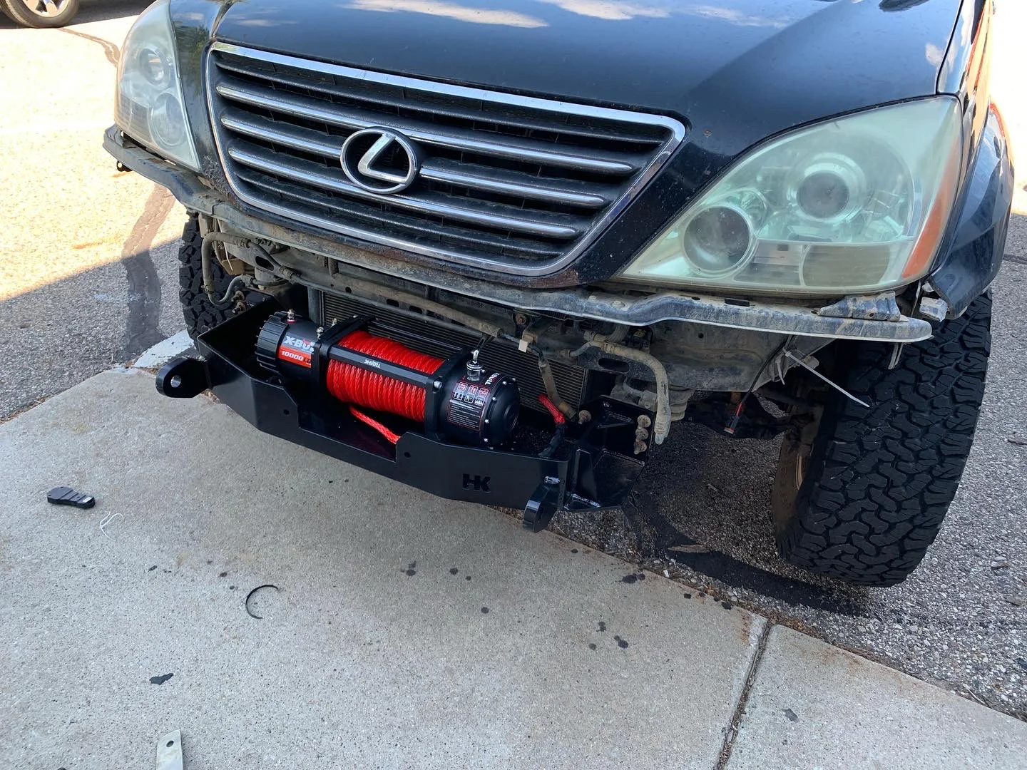

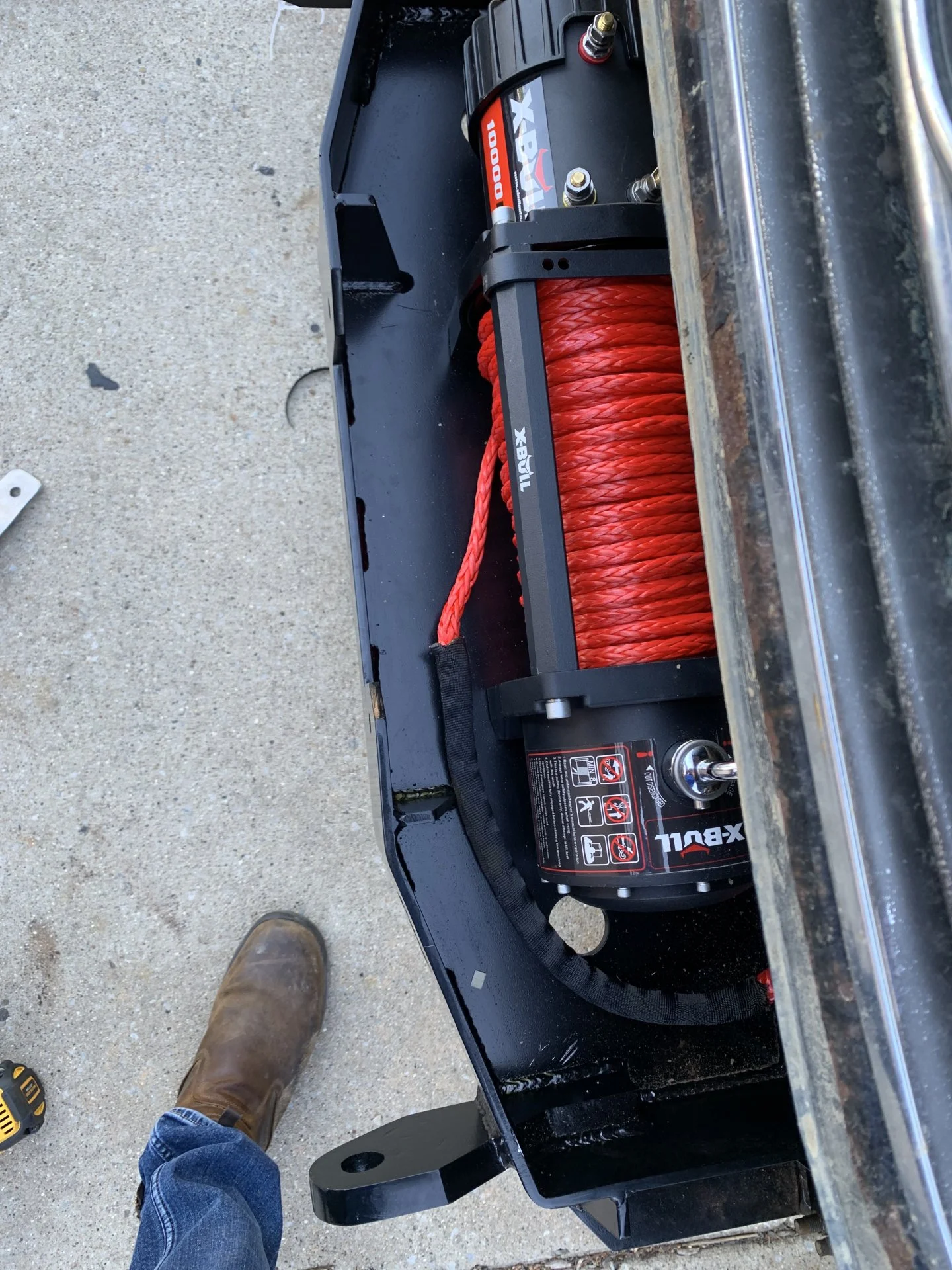

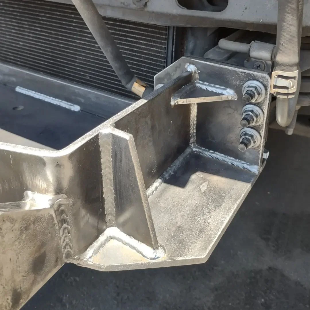

Hey guys I’m about halfway through my install on my hidden winch mount and wanted to share this as I’ve had a ton of people asking on Instagram about it. Alignment on this was perfect, it slid right on after removing the front bumper and supports. It’s extremely heavy duty with great welds and lots of support. Finish on it was excellent as well. Only issue I’ve had is my control box bumps the AC line in front of the radiator so I’m making a bracket to move the box slightly forward.
Weight is around 60#, probably a little less. It also ties in to the lower frame where the tie down hooks are.
I believe I’m the 2nd person to purchase this, and am very pleased with both the price point, communication from HK and the finished product. Hoping to finish up the install today and get pictures with the bumper cover back on.

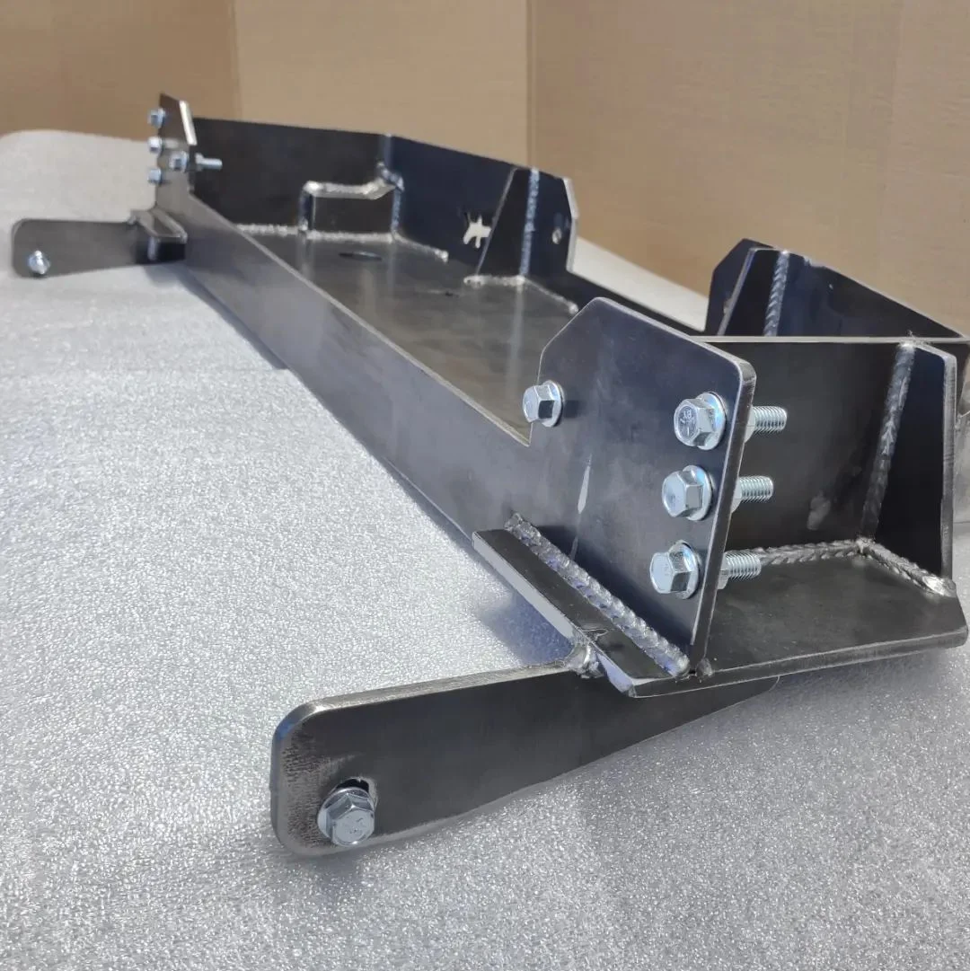

I'm not sure what the rear mounting plate looks like on another manufacturers product but we designed our winch plate with a solid 1/4" plate in the rear from frame to frame and added additional mounting plates under to mount to the side of the lower frame.
LFD is missing the additional HK mounting plate that bolts to the side of the lower frame.
Not sure what extra support that extra plate provides when winching
