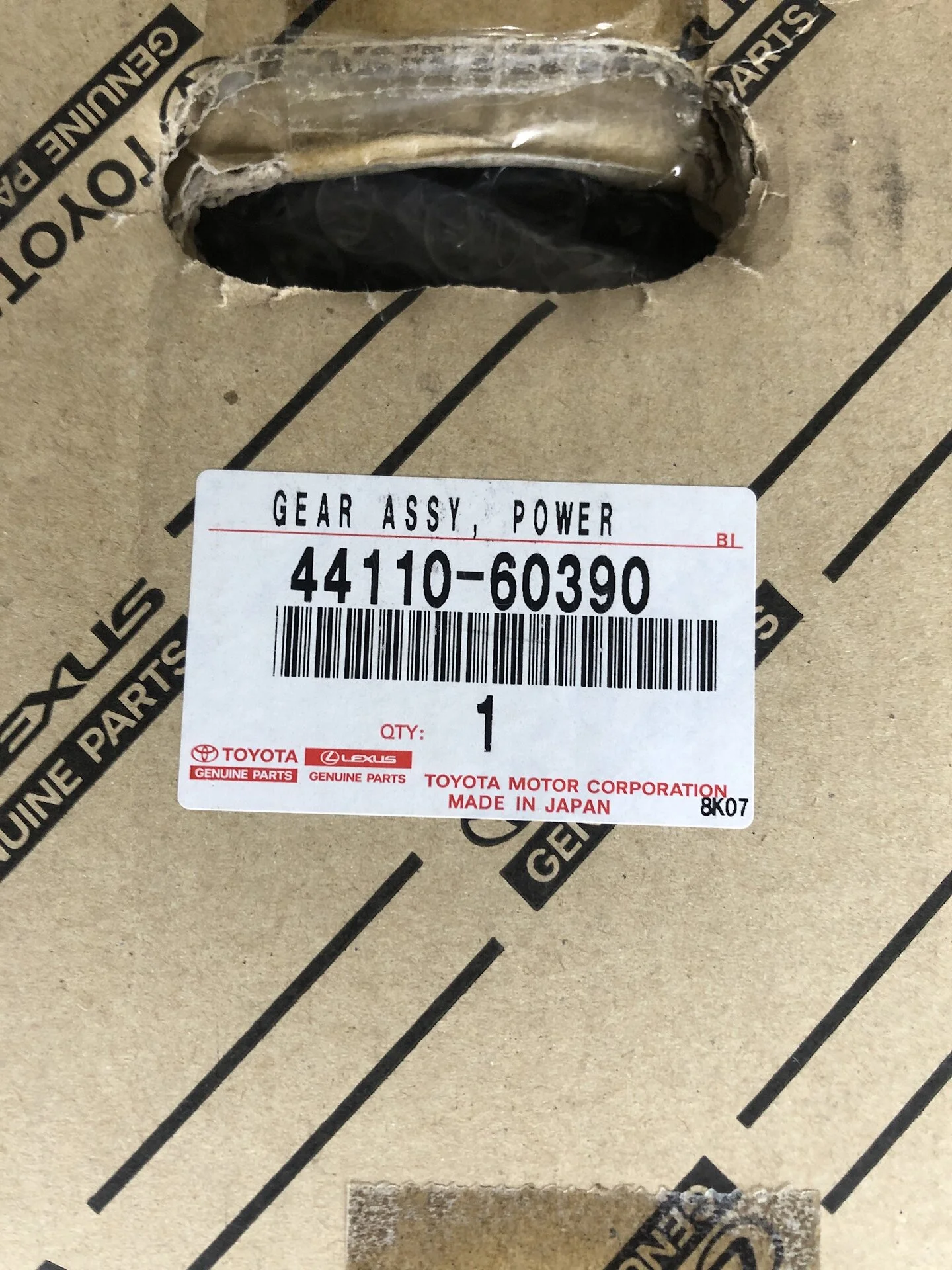

This is a RHD new OEM steering gear box. From a later HZJ7x.
Thats a power steering box, I guess? Do you have a part number by chance?
Nah, I just grabbed it all from a wreck. I didnt bother swapping pitman arms or anything, just straight in.
