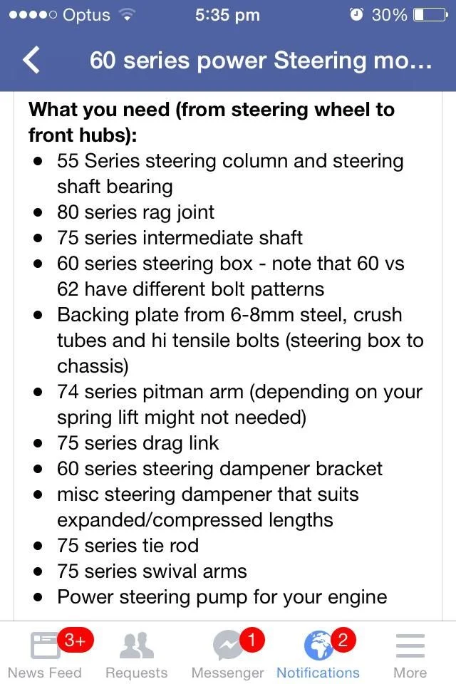

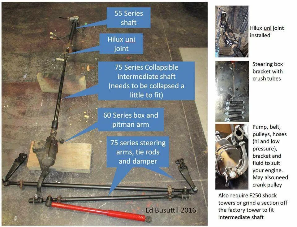

I have a hj47 I'd like to put powersteering on to. I got a 60 series steering box with the purchase of the van. I read on other forums that I need the 60 series swivel arms and 75 series steering arm and drag link.
I wanted to know why specifically the 75 series parts? Are the 70/75 front ends the same? Will the 70 series one work or not?
Also does the shock tower need to change for the 60 series box and the powersteering box bracket, will it work or does that need to be modified also?
Any help is much appreciated
