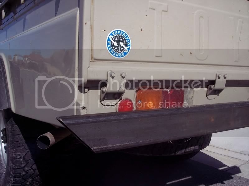

I made a mounting plate that bolts to a custom heavy crossmember. The receiver bolts to the frame. There will be outriggers to support it as well.
The gusset's for the safety chain. I need to shave off about another 1/8" so the bumper sits flush with the receiver.
I left the width long, because I have a matching camper shell and I'd like to leave that space for sleeping and living. Therefore swingouts are needed for the spare tire and wedco diesel cans.
I'm just not crazy about the shape of the 45* cuts and the extra width.

I would measure from the top point of the 45*/top of the bumper about an inch or two and cut it off. That would soften the 45 cut. That should leave you with enough room for the spindles then just cap the edges. So from the top it would be a 90* down an inch or so and then a 45*.
HTH.
Jack
I think thats where I'm going to end up jack. I did it with a piece of 2x4 out of wood and cut one end as your describing and the other at a 90* I liked your way better.
