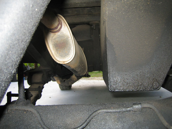

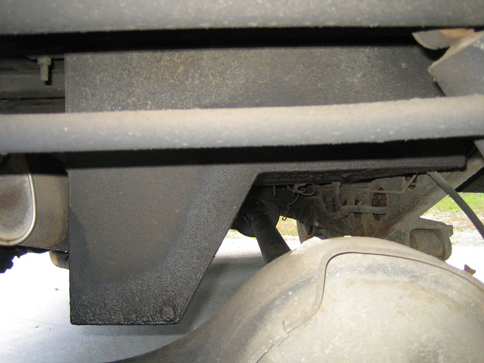

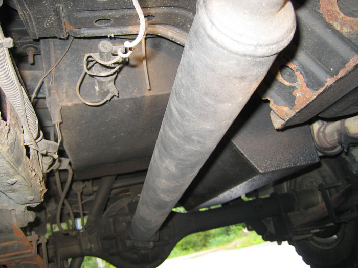

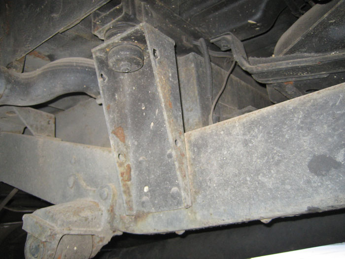

I snapped a few photos today of the aux tank in my Troopy. I wasn't able to find any logos, part numbers or anything that might indicate who made it. I suspect it's a custom unit. I have no idea what it's capacity is.
Here's some photos.

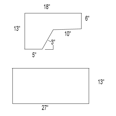

dimensions
Here's some dimensions on my aux tank in the photos above.
If you're thinking about building one the 5" long tank bottom could easily be extended to gain a little more capacity. The only limitation is your exhaust system. You could also change the sloped part of the tank to be 4" or 5" to gain a little extra clearance around the drive shaft.
I didn't include the location of the filler tube. I figured that would be a matter of personal preference.
