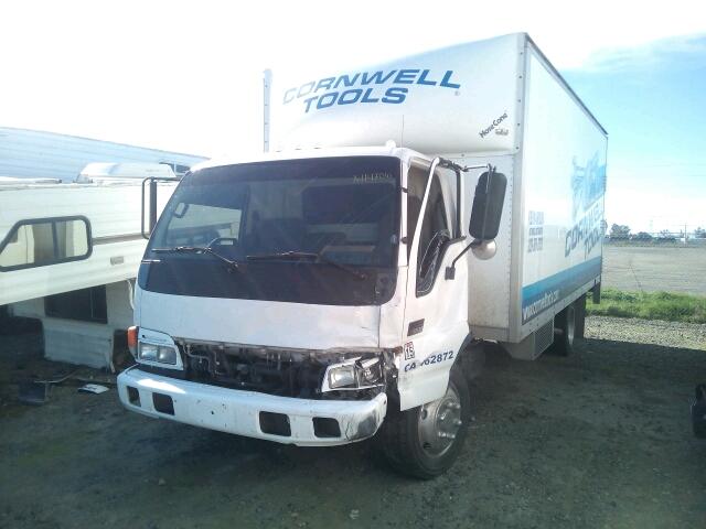

found a GM W5500 that's start-certified.
(this made by Isuzu and has the 4HE1, so perfect for me)
has 29 days left so guess its time to wait.

Missed that auction, the price got up to 3k. So now I have a new plan, and one that will get my parents to help pay for it (cause my brother will get the 80 and they don't have to buy him a car).
Shorten the Isuzu (<21' is my requirement so I can still park it easily), and convert it to 4wd with dana 60s front and rear (would go dana 80 rear but at $100 from my shop teacher I just can't pass up that good of a deal, and I don't need much for weight)
