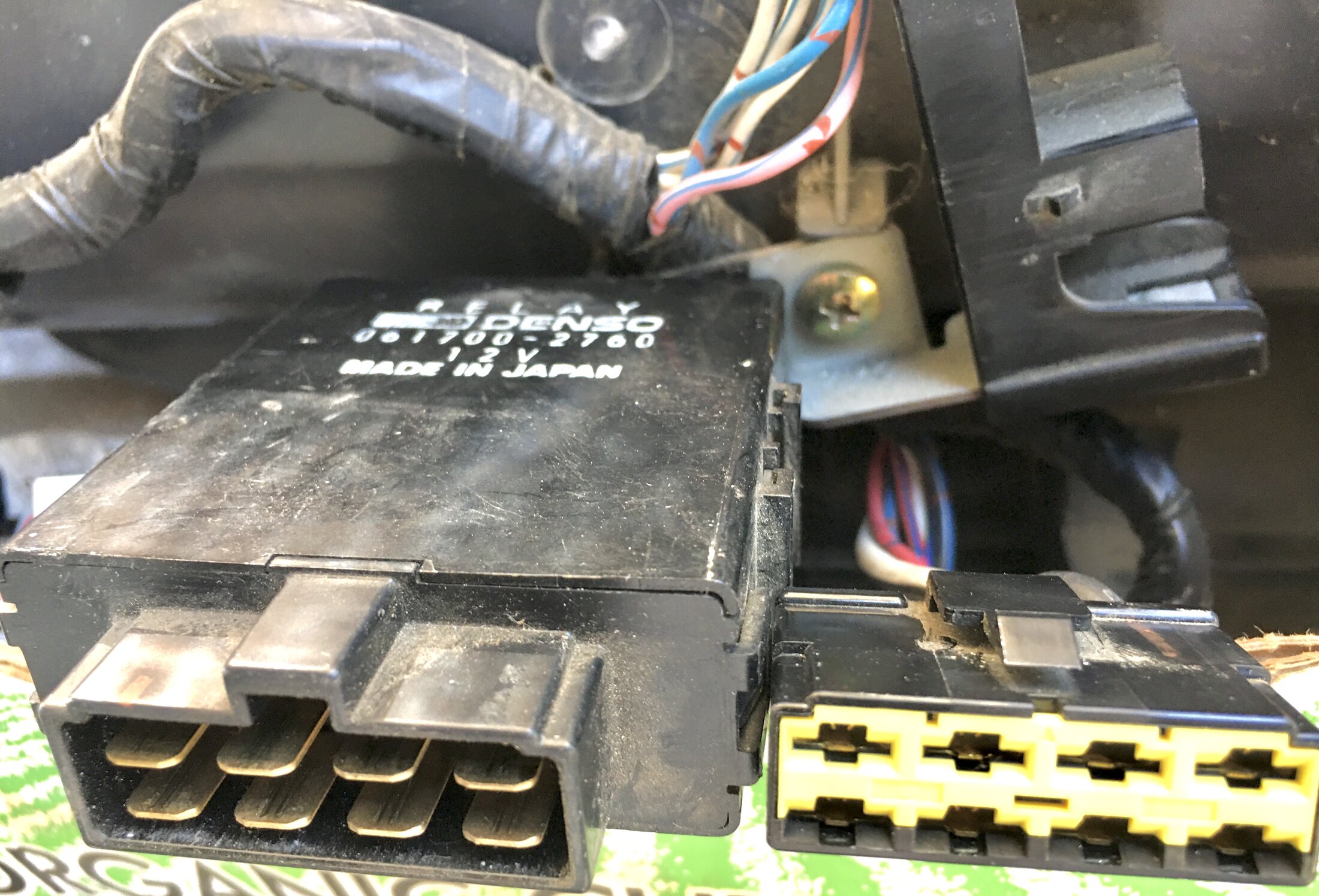

Production date 12 of 92. Wanted to ask how to remove high speed relay for the fan. Sitting right on top of the evaporator core and right below the dash. I'm assuming it has a screw holding it in the back. Before I remove the evaporator housing wanted to ask if someone's got a better procedure to do it. TIA
Here is the picture of the connector and a portion of the relay sitting right on top of the evaporator housing.
This is the relay number 88630-20020, trying to figure out if I need to remove the evaporator housing?

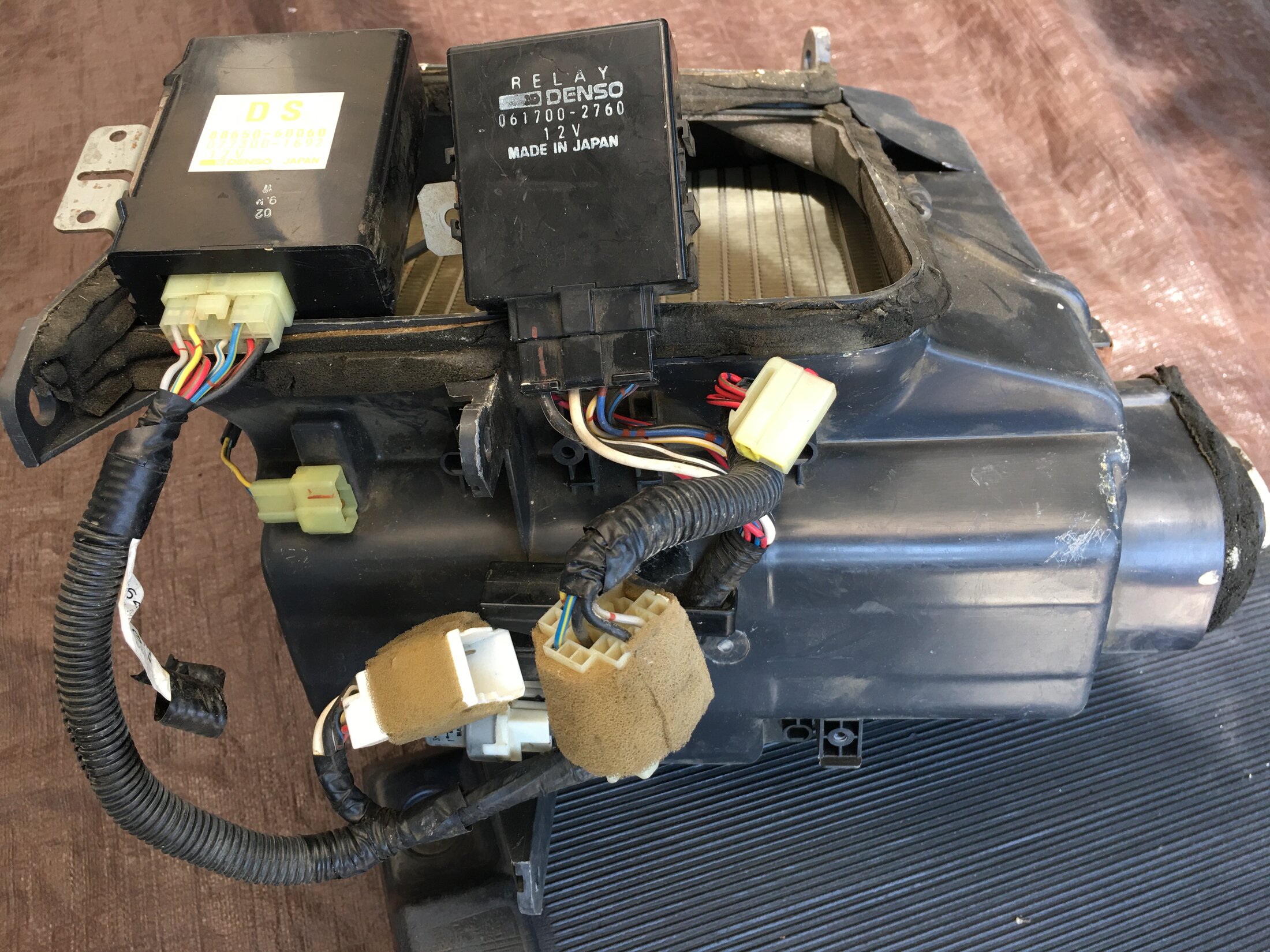

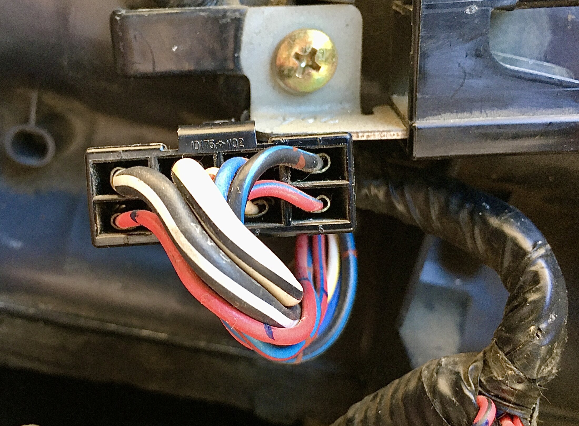

smaller relay in pic with black connector is 8-spade; this is from a '93 - pinouts may be different between fj and fzj but part number on this connector is 10175-Y02
cheers
Thank you so much, I believe it's the relay ending in 2760. I'll call the local dealer tomorrow and ask for that connector. hopefully it comes with a long pigtail I can reposition it to a different spot so I don't have to remove the evaporator to get to it. At least that's what the plan will be.
o sorry family prefix is 90980
so full part # is 90980-10175
Looks like that part is discontinued, I saw an image online but didn't look like it was eight terminals. The relay connector I'm looking for is with eight terminals.
