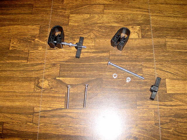

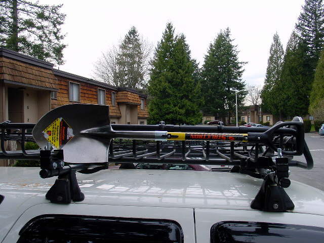

Make your own shovel mount.
Once again, Yakima plastic snaps to the rescue.
http://www.pnw4runners.com/tando/hilift_mount.htm
You have to scroll down.
I used the Yak Snap Around like I had used for the Slee Hi-Lift mount on the 4Runner.
If using a stock FJ rack, those Yakima 10V mounts will nce again let you do a home brewed shovel mount like I did.
Just sub the 10V mounts for the ones I have above.
