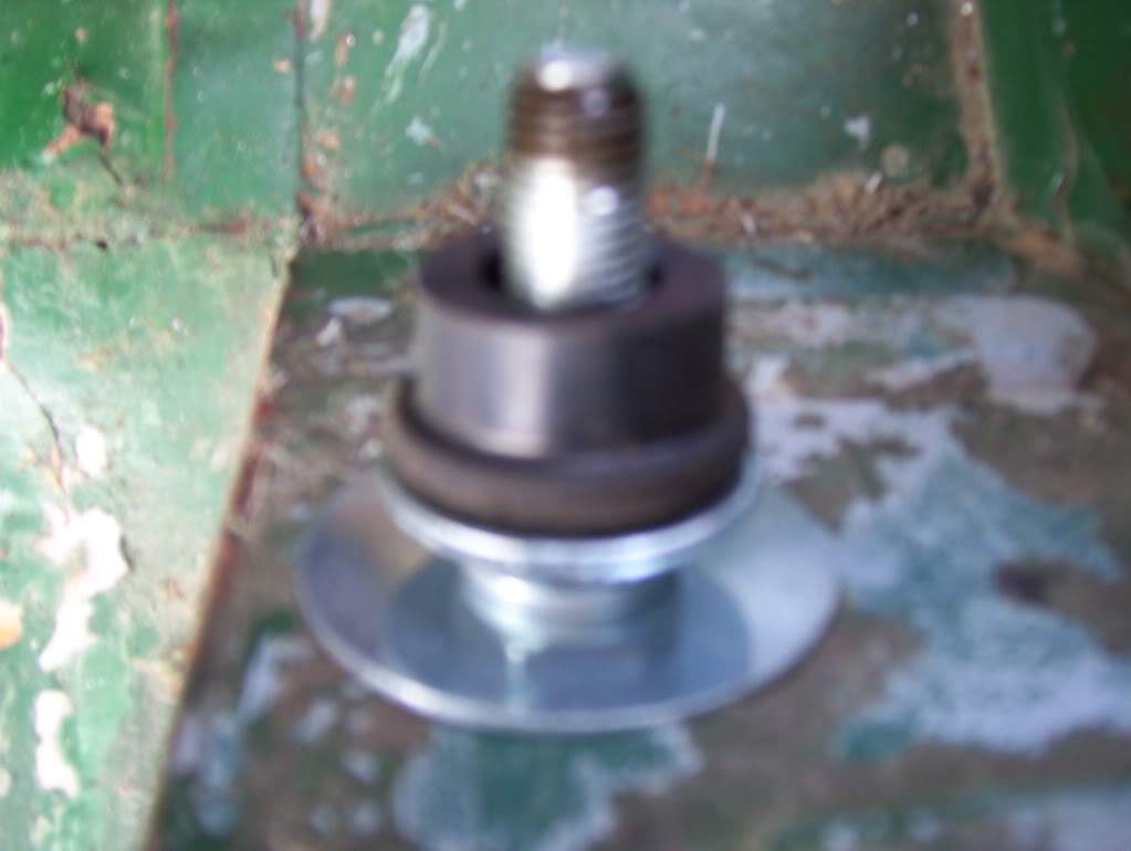

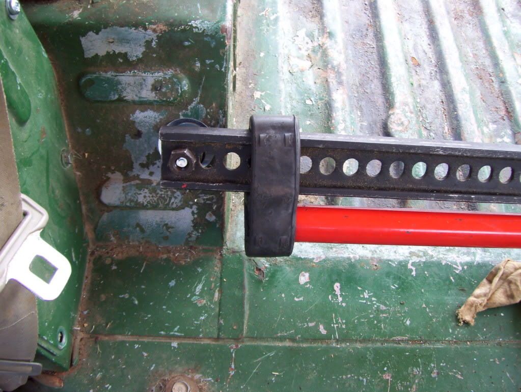

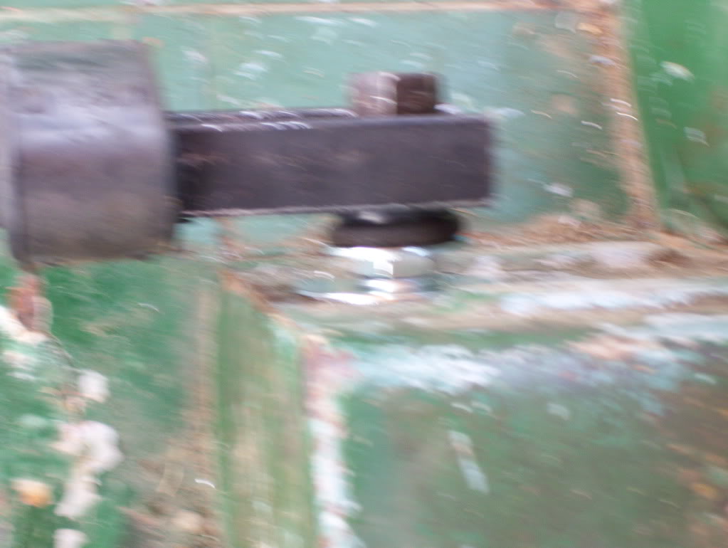

I keep mine inside. I put 12.5 x 5 x 75 mm bolts through the slanted part of my 1979 FJ40 wheel wells. I used fneder washers on each side and a nut on the inside to hold the bolt. I then put bushings I took out of out shocks over the bolts, then the jack and then spare lug nuts to hold it snug. I keep the handle snug to the bar with a muffler hanger I carved up. I strapped a shovel to the bar with bungees. This setup keeps the jack and acts as the front of my bed for anything that might slide around.

Do you have a pic of your mounting system? Thanks
Inside rack for hi-lift
I finally got around to taking the seats out and getting some pictures. I also changed out the 75mm bolt for a 50mm and cut one of the shock bushings in half. This cuts down on the movement. The stack up is M12x1.5x50mm bolt, 2 inch fender washer, WHEEL WELL, 2 inch fender washer, lock wacher, jam nut, regular washer, half of shock bushing, JACK, (spare) lug nut.
Of course, this onlhy works for the 48 inch jack.
