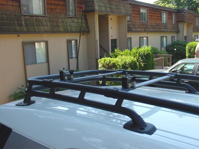

I have Slee's Hi Lift mounts on my roof rack now.
But dang, the roof is so darn tall on this rig, much taller than my 4Runner was where I could reach the Hi-Lift with ease.
I need to use a 4' ladder to wash the roof on this new beast.
I am thinking of using the mounts up there instead to put my old shovel up there.
It would be much easier to have the Hi-Lift on the spare tire like in the first photo.
