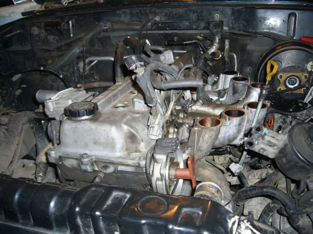

Almost exactly one month from the blown hg event, the cruiser is back in action.
A patient's Dad of mine who is a master mechanic did the repair, with me doing the scutt-work. I had a great time learning-I can replace my spark plugs, belts, replace a thermostat, water pump, alternator brushes and change my own oil :doh: now!
I would implore anyone with a blown hg to just do the repair- even better with someone who is willing to teach you.
I was a 1/2:banana: guy but I would say the hg can be done by most.
Thanks again Doug for the DVD. CruiserDan for the parts.
My mechanic Brian who did an excellent job and allowed me to participate and taught along the way!
I am wholly endorsing Brian to anyone in the Southern CA area for any work needed on your car-he is in no way intimidated by a hg repair and in fact enjoys wrenchin.
Give me a pm for his contact details.
Here are my obligatory pics!

couple more pics
One pic I don't have is the head back from the machine shop-oh so shiny. I had to use Brian's camera, once he emails it I will post it too.

Last two pics for now.
My headgasket blew at 173,000 miles luckily just after a 300 mile trip from mammoth.
The cruiser did not overheat, upon returning from the trip it started to idle roughly and later in the night the tail pipe was smoking white.
