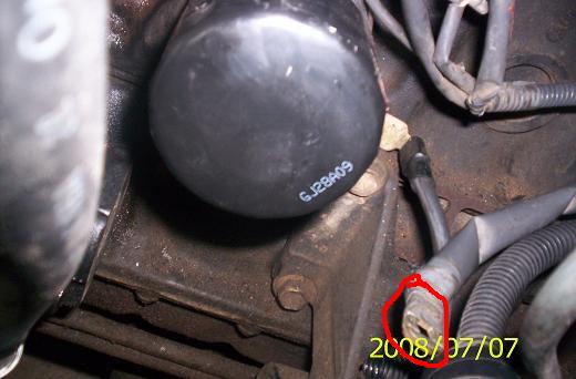

After lots of good advice reading many post i did my HG at 220000. Iam almost ready to see if she will start when i noticed a wire dangling between the starter and the oil filter. I thought this could go to the starter but not sure. Hope the picture come out. Any help would be greatly appreciated thanks.
It'd be a lot easier to see if it didn't have a date stamp AND a watermark on it. :D
-Spike
That is a ground wire for your VSS and other instruments. It bolts to the bottom side of your intake, sorta inline with your PHH.
Thanks i was going crazy trying to remember.If all goes well ill be driving her today. Time to turn off that date stamp on the camera.
