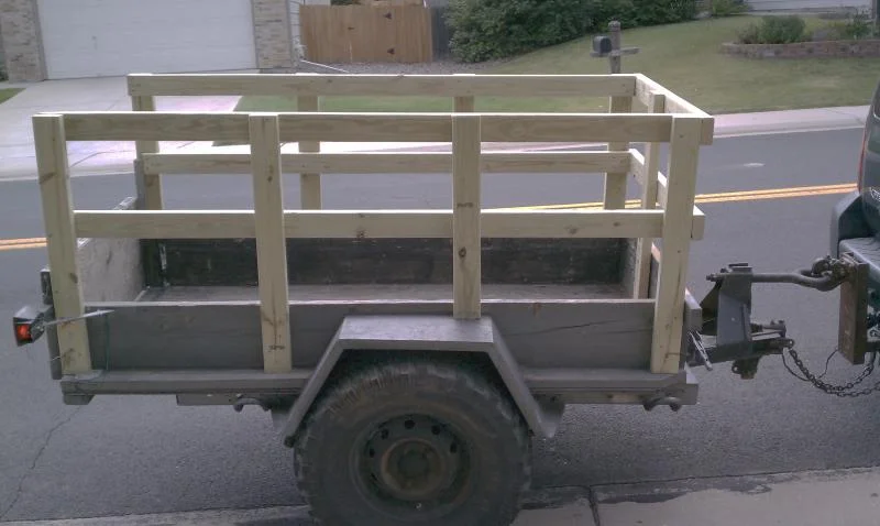

I dont like how the lunette is currently set-up with my reciever. The only reciever I have for this sits a good 18" higher than where my hitch reciever is mounted to the frame on my Xterra. This forces me to put the lunette in the highest position on the trailer to make it somewhat level.
I also dont like how the trailer seems to slap forward (when braking) and backward (when accelerating). I dont get that type of feeling (or sound) compared to when pulling a standard ball/coupler. I'm worried about the sway of the trailer when going faster than say 65 mph. Looking to take this next weekend to the mountains and dont want to go in the "super slow lane"...
see picture to current set-up
Thanks for the help!

that is one bizarre setup. Just lower the lunette...
also, this makes the effective tongue really short, seems like
And I'll bet that flaky engineering is at the root of the swaying, too.
You can pick up a decent pintle hitch for $40-$50 at most big box stores. Then just bolt it up as directly as you can. I don't think an Xterra has any way to directly mount it, like the 4 threaded holes on the back of Land Cruisers. The best thing to do then is to get the receiver mount in the photo above.
If you don't have lower mounting holes for the lunette on the trailer side of the equation, I'd highly recommend getting that cut off and a proper drawbar fabricated, with whatever coupling that works for you.
Seriously, a decent pintle and lunette setup will tow dead straight behind at 65 or whatever mph. I wouldn't want to tow that around the block, but I can be picky about my gear:p

Just remove the lunette and put it back where it belongs. That weird attachment is not original to the trailer and it looks dangerous. Lunettes have been used by the military for decades and they are the way to go for an off road trailer.
Whether or not the attachment was apart of the original trailer design is unknown to me, but almost all DRMO'd M762 trailers have that attachment. I presume it was so larger vehicles could tow the M762 trailers.
GISX, like others have mentioned, just move your lunette to the lower hole and pickup a pintle hook adapter mount like wengejor mentioned. I'm running one and my M762 follows behind me at 75mph with no problems at all.
The axle on that traier seems to be too forward on the trailer.. Im thinking this is why your trailer sways at speed and also why it slaps front and back.....
I also dont like how the trailer seems to slap forward (when braking) and backward (when accelerating). I'm worried about the sway of the trailer when going faster than say 65 mph.
Good catch! You can clearly see where someone lengthened the trailer with what appears to be a sheet of plywood and some framing. With that high pintle mount and the tail dragging I bet she sways!
