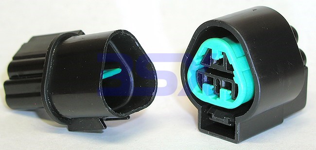

As the title states i am in need of help finding part numbers. I need the other end of the plug for the fuel sender on my hdj79. I would love to have the small amount of harness that comes with it. It is the 3 pin triangle plug. Thanks in advance

Pleasec post a pic of the side of the connector you want.
It looks like it may be a Deutsch brand connector.

Ok to 3 hours later i learnt something.... thanks to this pdf. So the part number for the plug on the end of my fuel sender is 90980-11015 (male). So, the part number for the female connector is 90980-11016. On the back of every plug is a number, the second section of the part number. So take this male 2p (pin) waterproof plug for example:
The number on the back of it is 11141. So part number 90980-11141. Therefore the female connector for this plug is 90980-11142. Sorry I'm probably just telling people stuff that they already knew but yeah, toyota stock the part i need thankfully.

Thanks for the reply, so i need the female side of the 3p connector. I don't have one to take a pic of.
I don't know my plugs very well, but this one is a toyota plug. Whether toyota use Deutsch i don't know. I really appreciate the link too.
